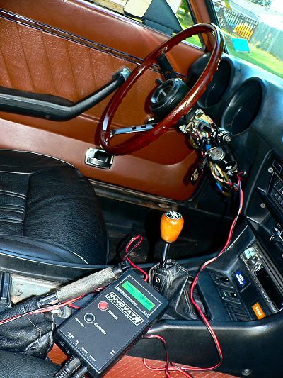

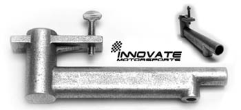

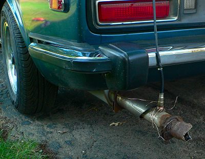

Innovate LM-1 In the cabin:
That's a neat setup. And I assume a lot easier to use than a colortune for when you're driving around.
What's the response time like? Do you think it would pick up Oiluj's transient states?
