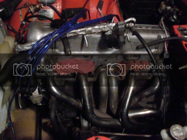

I am running twice pipes(2" each) from a header. It is cool seeing you do all this data work with the dyno. I have only dynoed my L24 once at Zcon and made 150/150 roughly with badly tuned SU's. I found that out after installing my wideband. I was running lean when I thought I was running reach, so I think the tool is a necessity for fine tuning. I am getting ready to re-dyno my car since I have cleaned up the tune on my SU's. I will be doing kind of the opposite as I will be going for timing parameters -primarily.

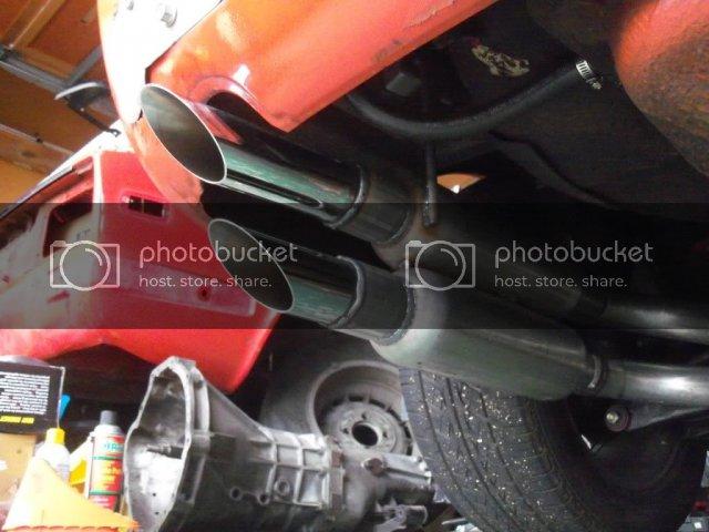

I can say for a FACT, you will love the sound of the duals on the L engine. I was actually attempting to make an in-car video the other day to share the sound, but it will have to take some tweeking. I can't wait to install my Mikunis and compare dyno sheets.

I've followed your posts as well Steve, your duals are awesome! You and Chris have definitely helped convince me to go with duals. I'm also using 2" pipes along with 2 glasspacks per pipe. Believe me, I've just about looked up as many twice pipe videos as possible, but I haven't heard any in person yet. Your exhaust sounds great, get the wife to film a driving video!
I hope the car will be ready tomorrow. I'd also be really curious to see the differences an X-pipe makes with the duals, as I know you have an X-pipe. As far as comparing dyno results, it's really tough to do with different dynos especially if they are different types of dynos. You really want to use the same dyno every time you test so that the results are comparable.
However, we can make a valid comparison of the torque curve's shape. Basically, different length and diameter manifolds will create peaks at different rpm. These peaks are also dependent on cam specs, cylinder bore, and combustion chamber volume. If you have dyno sheets, post them up, and from there we can make comparisons of the effectiveness of different intake and exhaust manifolds, along with different cams and compression ratios.

I was actually using a small step ladder with the camera mounted to it in the hatch, but it needs some stability improvements.
I was hoping the X pipe would have helped the drone issue with these cars, but I don't know if it helped. It is pretty damn loud to start with-especially under load around 2300rpm.
I am also running a cheapo MSA header that has unequal lenghts, so I know affects things also.
Warning: two glass packs only will be very loud. I also have two magnaflow mufflers and it's still pretty loud
Did I mention that it sounds freakin awesome:cool:. Can't wait for them Mikunisssssss

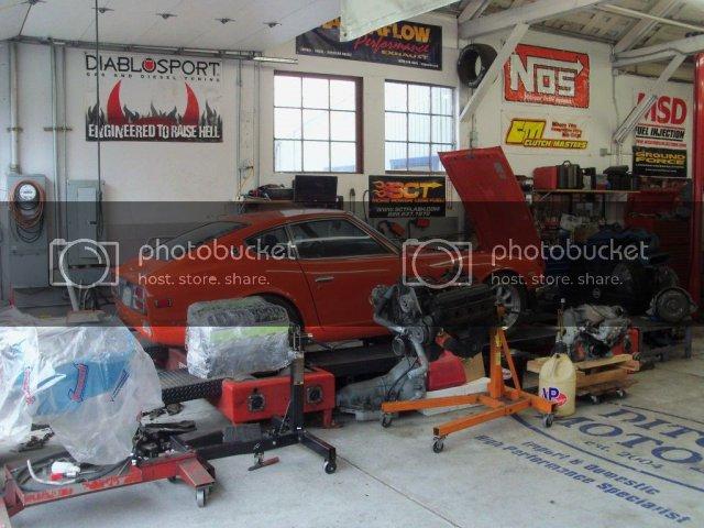

Testing was done at Dito's Motors in South San Francisco on a Dynomite load-bearing dyno. Robert and David are great guys to work with!
