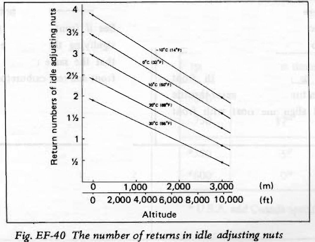

FYI Here is what the 72 FSM gives for temp and altitude compensation:
More interesting stuff, Blue. If I'm reading this right, it appears that I should enrich the fuel mixture 1/2 a turn, maybe 3/4 turn, for my commute home. A 30 F temperature rise during the day isn't that unusual in these parts.
Chris
Chris
Now that I think about it, adjusting the mixture is the last step of my tune-up routine and I'm usually doing it between 3:00 and 6:00 in the afternoon. So I should be going the other way. Lean it out for the morning commute, back to setting for commuting home.
Chris

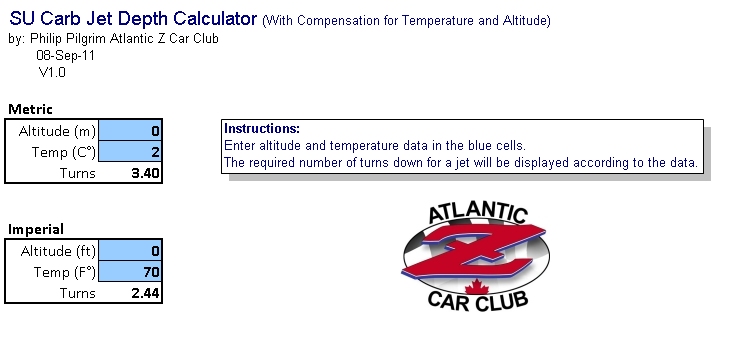

I am about to stat modeling the flat top SU so I decided to model the jet depth to get my head back into the game. It has been a while since I had such output.
Here is an xls tool that models the graph. I will probably make a visual basic tool shortly for fun and eventually a java version when I get around to setting up a new tech tip website.
Note: This is a Microsoft Excel (XLS) Tool
Enjoy: Hitachi Jet Depth Calculator
240z260zSUJetDepthCompTool.xls
Edited by Blue
The chart shows the absolute depth of the jet: i.e. The number of turns down from the very top.
For this chart to mach your carbs, you need your carbs set up correctly with factory parts and also in good working order with no worn or out-of-spec parts.
With respect to which way to turn:
1. When it is colder (denser air and more stuff to burn up), you need to add more fuel; so the jet must be lowered to expose more "hole/orifice" gap between needle and nozzle as this exposes more fuel.
2. When you drive higher in elevation (thinner air and less stuff to burn up), you need to reduce fuel; so the jet must be raised to expose reduce "hole/orifice" gap between needle and nozzle as this exposes less fuel.
So in a cold morning you need more fuel than on a hotter afternoon.... so the jet is lower in the morning and higher in the afternoon.
I would just set it in between both and be lazy :) FYI my opinion on daylight saving time is for everyone to move 30min then just leave it :)
