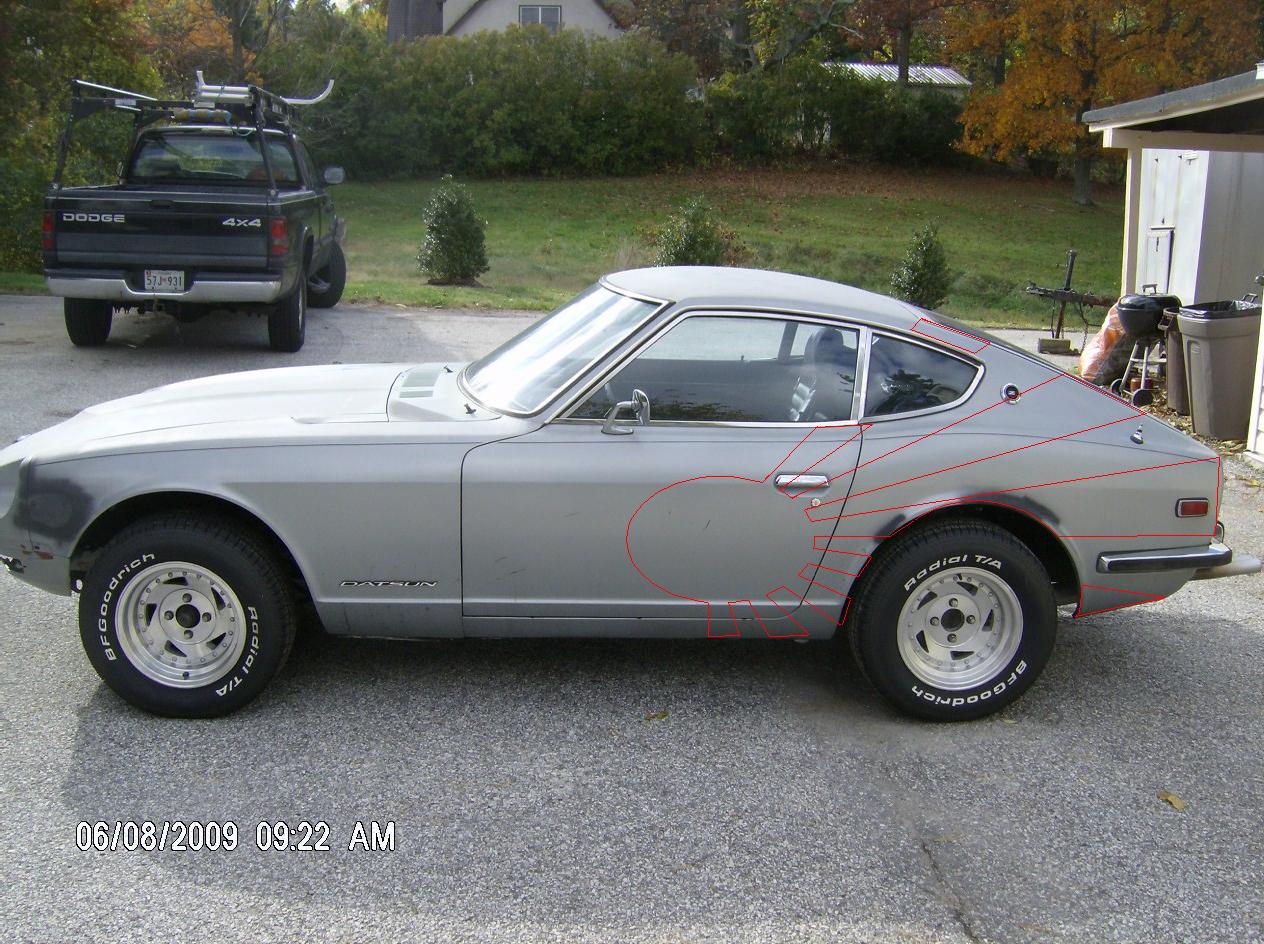

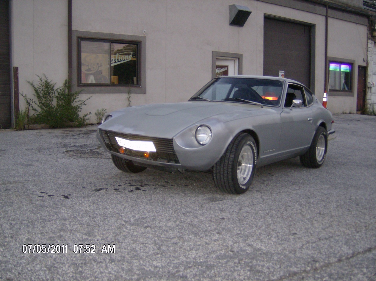

I put 235/60R14 tires on all the way around and experienced rubbing till I put the new Stiff springs up front. The back still rub on big bumps but no longer on curves. The new springs will fix the rear rub when I get healthy enough to install them. They look really good when they are shined up. Hope this helps.

Now 5th you're saying 235 60 14 caused rubbing, until you replaced the springs but still rubs on bumps? It looks like clearance is fine from the top and sides of tire so was it rubbing against the sides?
My springs were mush, I did the fronts, then got slammed with work. Work load lightened, and I turned around and broke a few ribs. I actually drove the car for the first time today since hurting myself, but I'm still weeks away from being able to do the rear suspension. So, the rear of the car is still very loose spring wise, and when I hit a hump, dip or big bump the rear tires rub ever so slightly against the return, or lip of the quarter panels.
