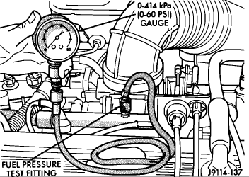

Related to what Cozye was saying - When I was rebuilding my engine, I took the Fuel Rail and brazed in a Ford fuel pressure fitting so that I could easily run the 3M cleaner through this port as well as check the fuel pressure. It comes in handy to check pressure without having to pull any lines, etc.
I use an Actron Fuel Pressure Test Kit - CP7818 to monitor.
http://www.actron.com/product_detail.php?pid=16174
Attached is a stock drawing of the setup. I'll see if I can take a pic of my install.
Hey Andrew, that looks like the way to go. Very nice. I think I'll do that.
