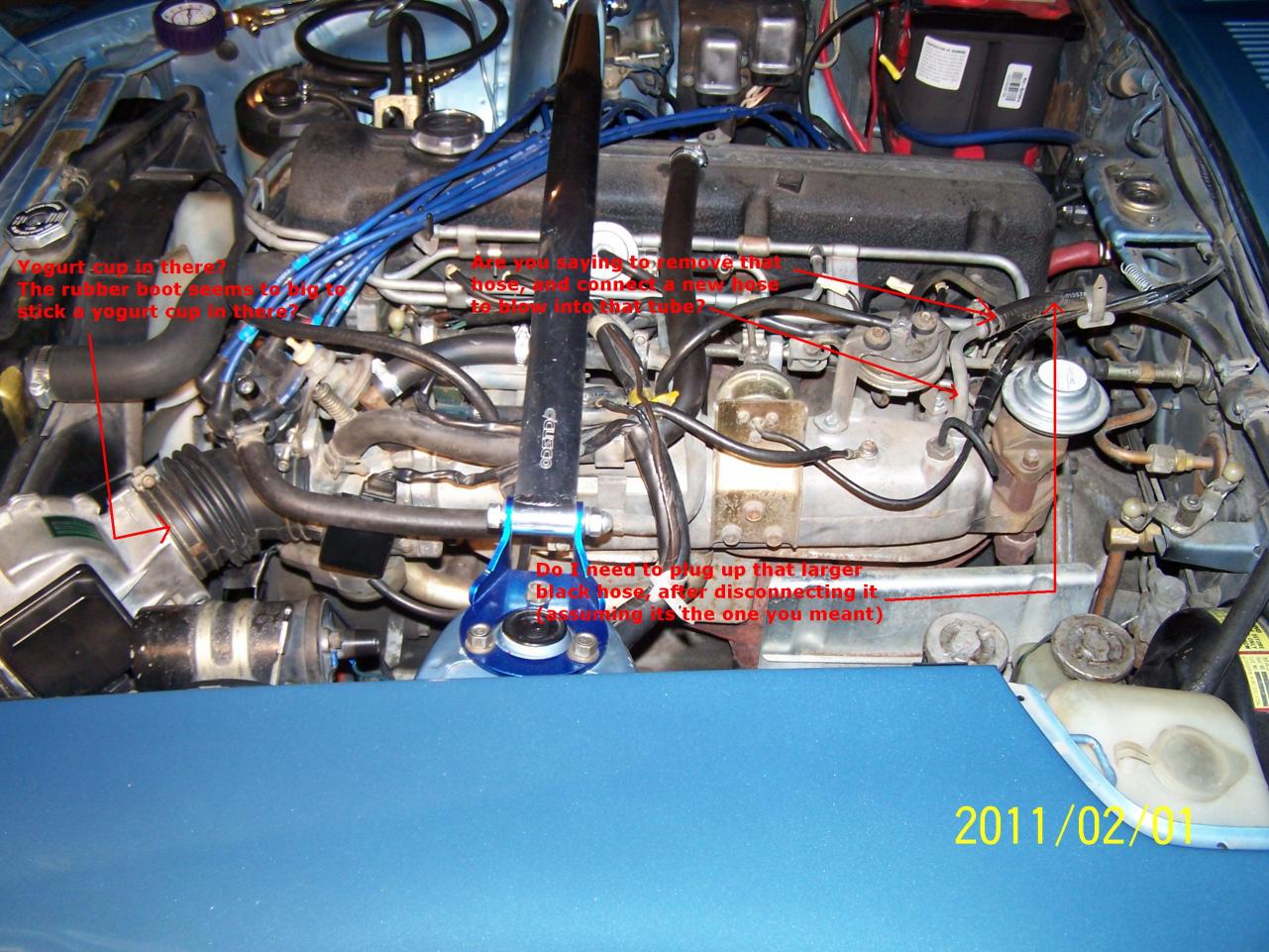

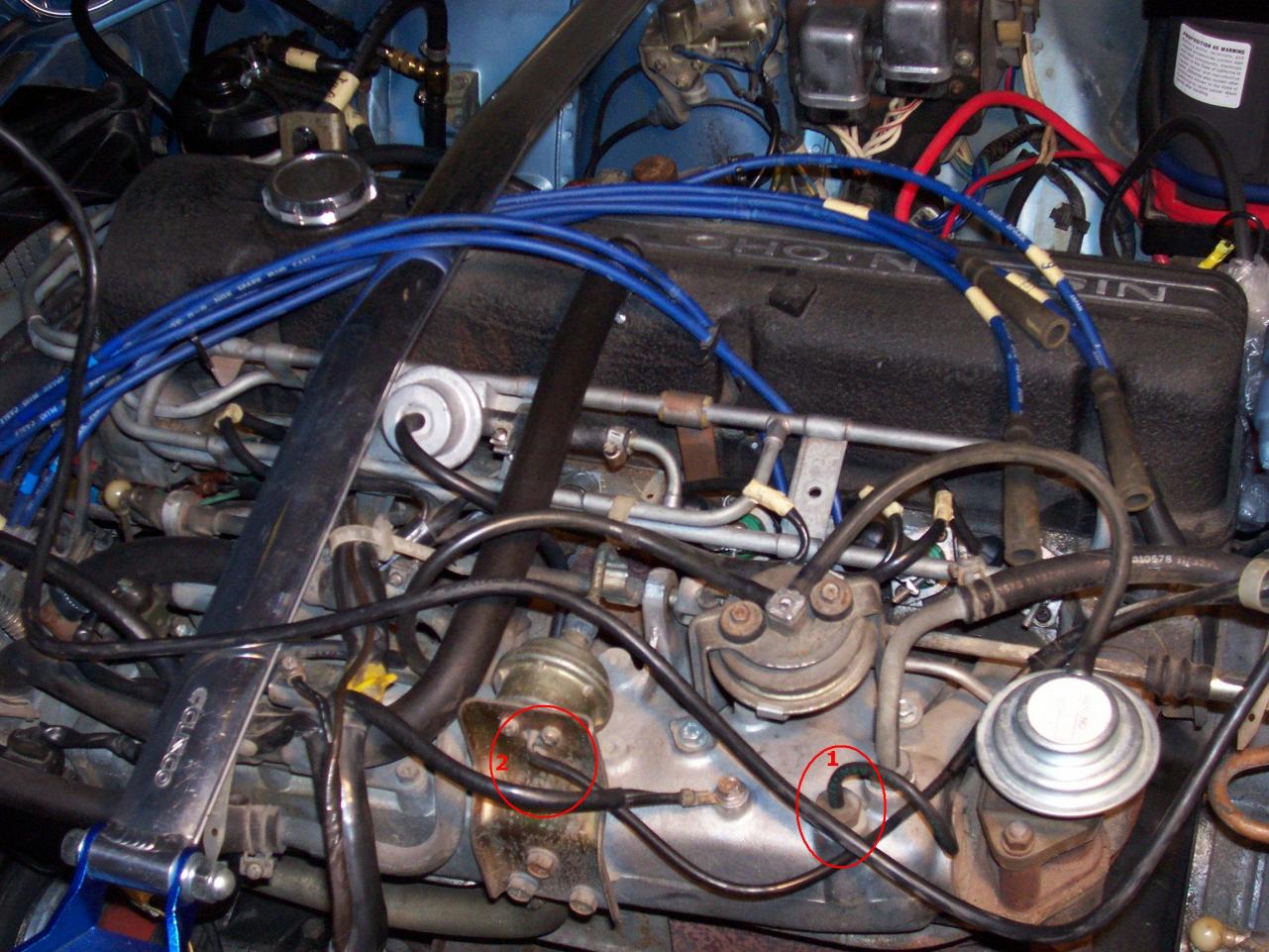

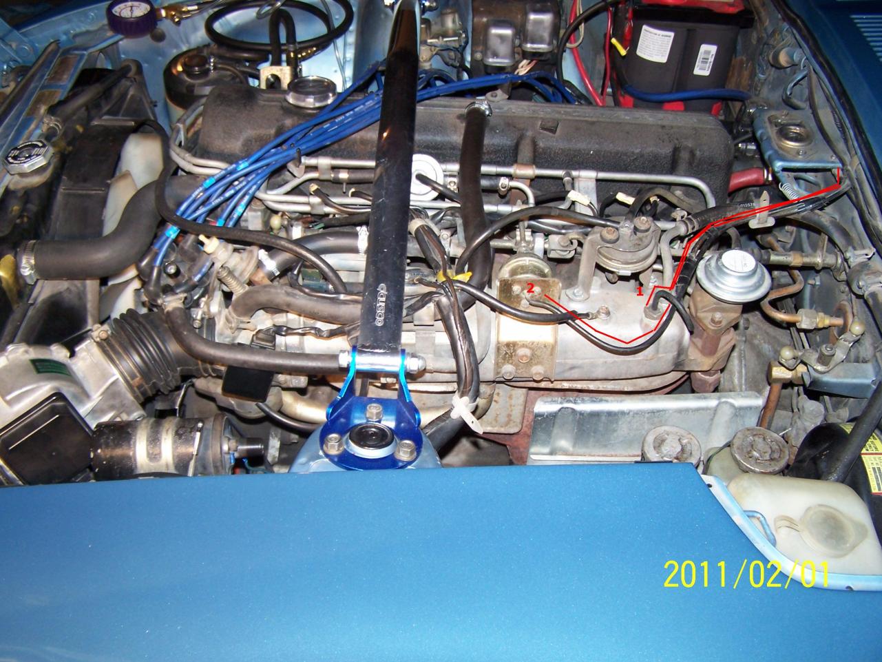

April 17, 201114 yr Author comment_353085 Well the numbers were done when stone cold, and arent they supposed to be .008 for intake and .010 for exhaust? So based on that, would these numbers be bad enough to cause running/vacuum problems in the engine? And no, I didnt do the yougurt cup test. I just really wanted to see how my valves looked, even if I didnt adjust them yet. So I had some idea if they could be the source of my low vacuum condition or not. This will seem dumb, but since I currently have the rocker cover off, can I do the yogurt cup test with that off. I mean the engine is all interconnected, and I just am not sure if having it off would effect that test or not. Because some of the intake valves could be open... Are you talking about pulling off the vac line #1 in my pics? And capping it off, then I could eliminate any possible leaks happening from the HVAC system, or should I say it would eliminate them from the equation. And limit down the scope of any vacuum leaks. Those guys smoke tester did not send any smoke out anywhere. But I also didnt look inside the cabin like under the dash where I suppose these lines are coming in. And BTW, what is Vac line #2 in the picture. I am not sure what that is, but its running side by side with the other one. Edited April 17, 201114 yr by argniest Link to comment https://www.classiczcars.com/forums/topic/39247-noob-valve-adjusting-on-1978-280z/?&page=2#findComment-353085 Share on other sites More sharing options...
April 17, 201114 yr comment_353088 The rocker cover has to be installed to do my yogurt cup test. When you do this test, you'll be testing for tightness EVERYWHERE. This will include rocker cover, oil pan, oil filler cap, dipstick, intake manifold gasket, several closed intake valves, the piston rings and exhaust valves on the other side of one or two open intake valves, etc. The test won't pinpoint where you have a leak, but it will certainly confirm whether you have a leak that you need to track down. Cold valve lash measurements aren't as reliable as hot measurements. Having said that, I suppose your exhaust gaps look a bit loose and intake gaps OK. Still needs adjusting, but nothing too far out of the ordinary. I wouldn't expect much improvement in the running condition of your engine from the adjustments. Your engine might run a tiny bit quieter -- less ticking. I doubt you'll gain much, if any, engine vacuum. Link to comment https://www.classiczcars.com/forums/topic/39247-noob-valve-adjusting-on-1978-280z/?&page=2#findComment-353088 Share on other sites More sharing options...

April 17, 201114 yr Author comment_353100 Honestly the solution to getting your engine right might be the systematic correction of a whole bunch of little problems like this one. Yeah, I have to believe that is exactly what is happening, a whole bunch of little problems. and maybe bigger ones that I caused when I repalced FI's. Here is what you said: "1) I pulled off the AFM and plugged the AFM-to-throttle boot with a yogurt cup. I pulled off the vacuum booster line to the brakes and attached a hose to blow through. I pressurized the intake with nothing but moderate lung power, held the pressure with my mouth, and got a feel for how long it took for the pressure to leak away. I then pulled the little HVAC vacuum control line (adjacent to the power brake vacuum line) and repeated the test." I dont see how a yogurt cup would plug that space up? It seems like the hole is 2x thats size? Where is vacuum booster line? I just want to make sure I am doing the right thing here....And you are saying to take the AFM off the car. It seems with a yougurt cup in there, and then blowing into the intake system, isnt that just going to push the yogurt cup right out of there whenI start blowing into the hose I would attached. I know....more stupid questions. I ATTACHED A PICTURE OF WHAT I THINK YOU ARE TALKING ABOUT, CAN YOU TAKE A LOOK AT THE PIC, THANKS! Edited April 17, 201114 yr by argniest Link to comment https://www.classiczcars.com/forums/topic/39247-noob-valve-adjusting-on-1978-280z/?&page=2#findComment-353100 Share on other sites More sharing options...
