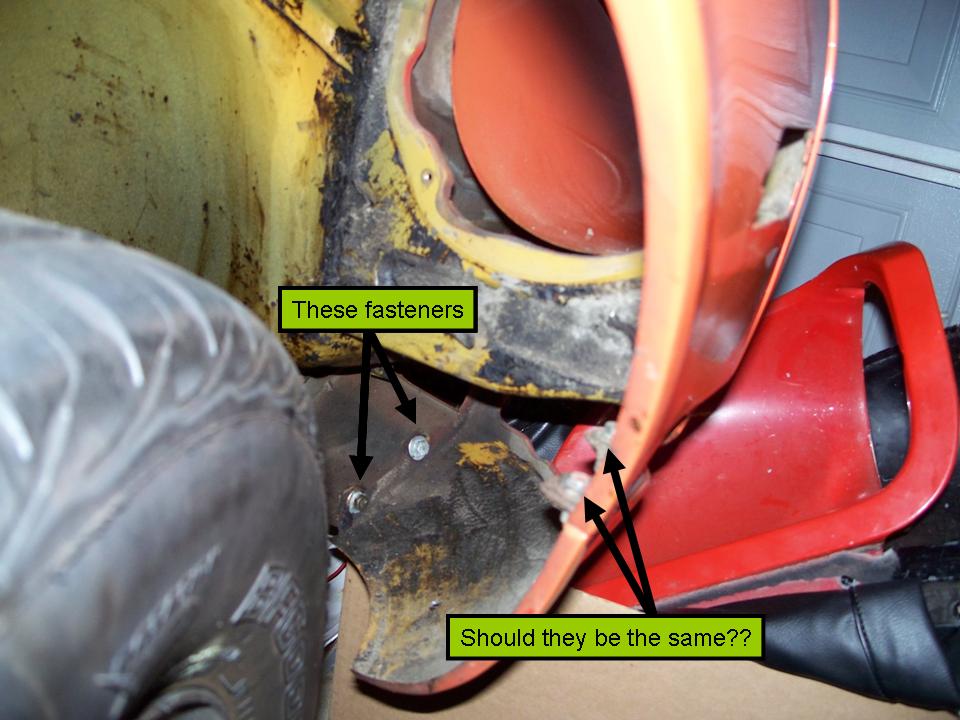

My parts catalog and the online factory parts listing don't have the bolts, nuts, washers or anything else to connect the front apron to the lower fender panel. Does anyone have the part numbers needed?

I should have posted pictures to help. This picture is looking into the front right fender. Please let me know if the question in the picture if correct I can get the part numbers for that part of the car.

I believe the answer to your question in the picture is, yes, they are all the same fasteners. A total of 8 of these fasteners and the associated through bolts, 4 to fasten the center valance to fender aprons, and 4 to fasten fender aprons to fenders. From your picture, I am assuming that the fasteners are the same as in my
picture in item #2 above.
If you have the parts CD on page 105-3:
item 28 part #63140-78500 is the fastener
item 29 part #77720-89908 is the machine screw

Mine on the side are the same. The last owner took a hit in the DS headlight and grill. He gave me all the parts, but the damage bucket. Well they replaced the fasteners with hardware store whatevers, at least they used metric. Thanks you have been a great help now I know what to order.
