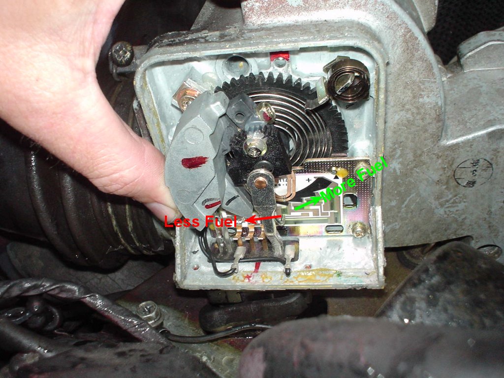

Having read practically everything on this site with regard to the EFI system, I thought it might be a good idea to remove the black plastic cover of the AFM and do a visual check while it's on the bench, of the internal components and reseal the cover. I had a copy of the AtlanticZ AFM write-up and I discovered that watch spring coil or "return-to-zero shock absorber" is missing and the tab mount is bent. After I took photos, I also realized that part of the bracket for the spring is missing-the "keeper" or "stop", if you will.
It looks as if a PO or even a reman. tech may have tried to repair the broken bracket with an epoxy.
[ see photos]
I assume all components are there for a reason, some for better reasons than others. I am thinkinking of a way to fix it. Haven't come up with an idea, perhaps a rubber bumber to soften the return of the counterweight. Open to any thoughts on the problem.
BTW, the second photo is from the AFM worksheet ( for reference)
The yellow arrow in my photo points to the gray blob of epoxy(?) and the red arrow points to the tab (no spring) which is bent downward.
The AFM looks otherwise, pristine and unmolested. Obviously, someone's been in it but there is no evidence of repairs/tampering/adjustments.

Appreciate your thoughts. So you're saying that a mechanical fix, like substituting for the return spring absorber to protect the counter-weight wouldn't be worth the effort?
It's not the adjuster spring or anything electronic. I intend to reseal the cover against dirt/ moisture.
I thinking that other than the broken bracket which is only necessary to bring the counter-weight to a "soft" stop the AFM is working perfectly. I fear introducing new issues with a reman unit, more than what I have. I hear you on the warranty issue and the mean-time-to-failure life of a new(er) part.
I don't think that shock absorber is that critical an item, but I could be wrong.

There are two screws at the bottom of the box- covered as you described. I used solvent (carefully) to disolve the glue, also removed the collar and gaskets so as to be able to tap the plate outward from the inside.
There are no exploding parts. :D I took photos that I will upload later.
I found the source of the sticking (previously posted). The corners of the vane were overtraveling in the chamber, jamming at full travel there were shiny spots as a clue. I thought about deburring them but I gently took some of the arc out of the end of the vane- a tiny bit. Seems counter-intuitive but when looking at the shape of the vane and where it was rubbing, that seemed to be the answer. And it worked. Having the plate off and the innards exposed, allowed for a thorough cleaning, particularly the backfire valve, which was corroded enough to stick badly.
With the plate off, I decided to re-create a post for a spring/bumper, working from the inside. I drilled a small hole from the electronics side, countersunk from the chamber side, so that a small diameter flush head screw wouldn't interfere with the edge of the vane during it's travel. Washer, locking nut,finished. Cleaned plate, box edge, reassembled with silicone...
Searching my "MacGyver" box, I found a hi-temp silicone rubber sleeve that fit tightly over the portruding bolt, allowing for a "soft stop" against the shoulder of the counterweight. Sealed plastic cover and re-installed AFM.
Lo and behold, it started!
