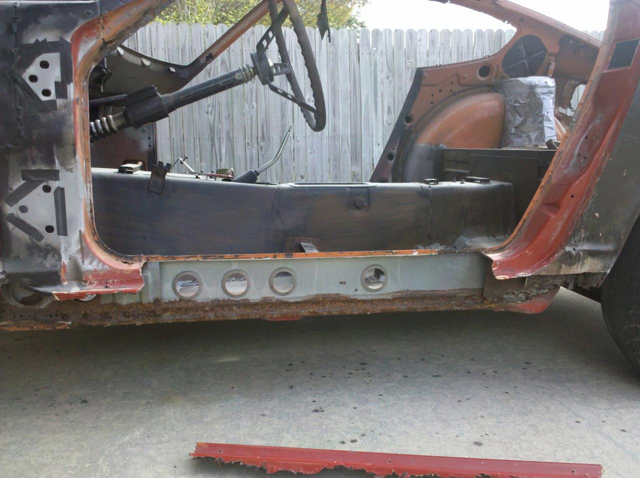

My driver side rocker panel is badly dented. Looks like the car was driven over a tree stump. How hard is it to replace the rocker panel. I think the damage is too much to fix. I need to replace the dog leg..

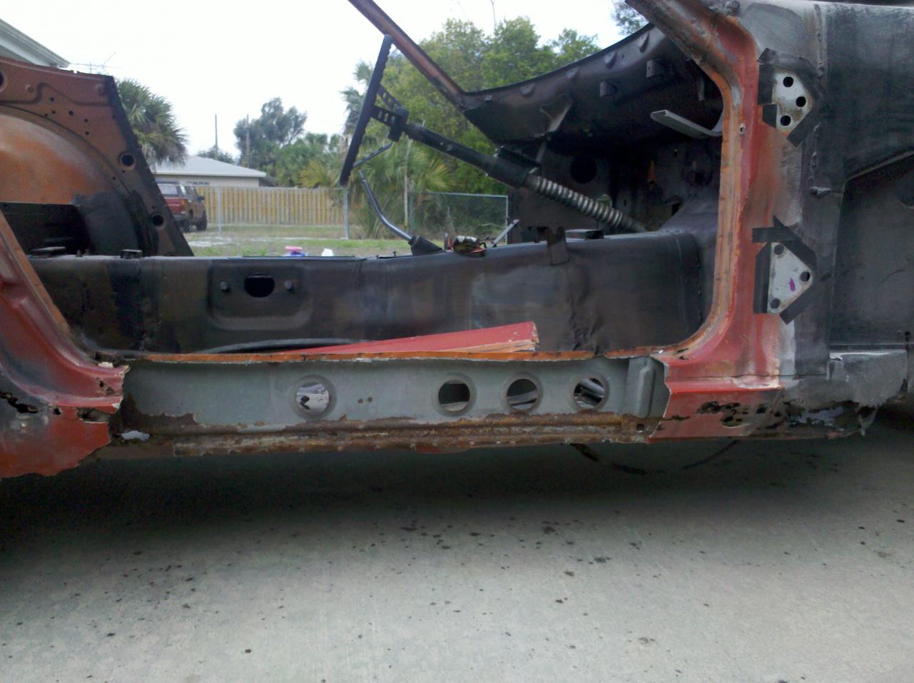

This is what it looks like when you take them off. Mine were cancered pretty badly so they had to come off for complete restoration. Also do a general search for ROCKER PANEL REPLACEMENT on this site. There are some good photos of what the replacement part looks like as well as installation. It can be done with the right tools and patience. Don't weld it until it fits perfectly. If you have to a professional can fit them for you.
