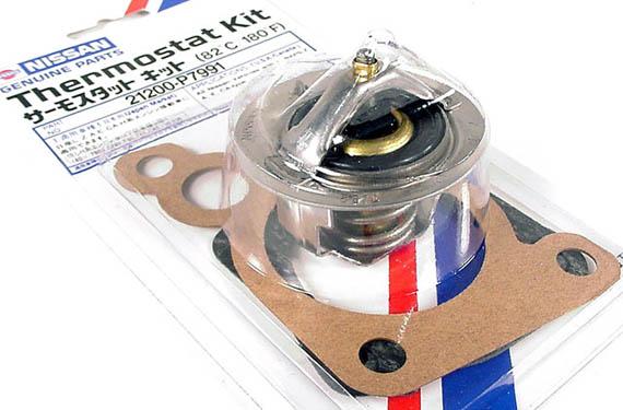

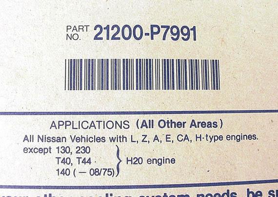

Wouldn't you know it just after I post this, I finally find the part number online by searching high res photos.
Here it is for future reference to all: 21200-P7991
Mods if this is a waste of time feel free to delete.
That's a 180 degree thermostat. But I think that should read 21200-P7901. I don't know how to differentiate them by number I just know that is the number for a 180. 21200-F3160 is a 160 degree, 21200-P7901 is 180 degree, and 21200-P7906 is 190 degree.
