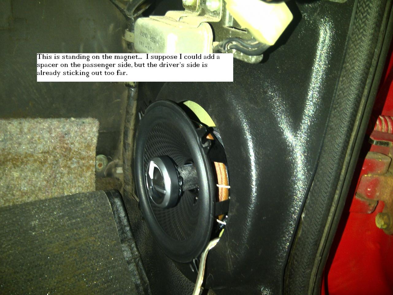

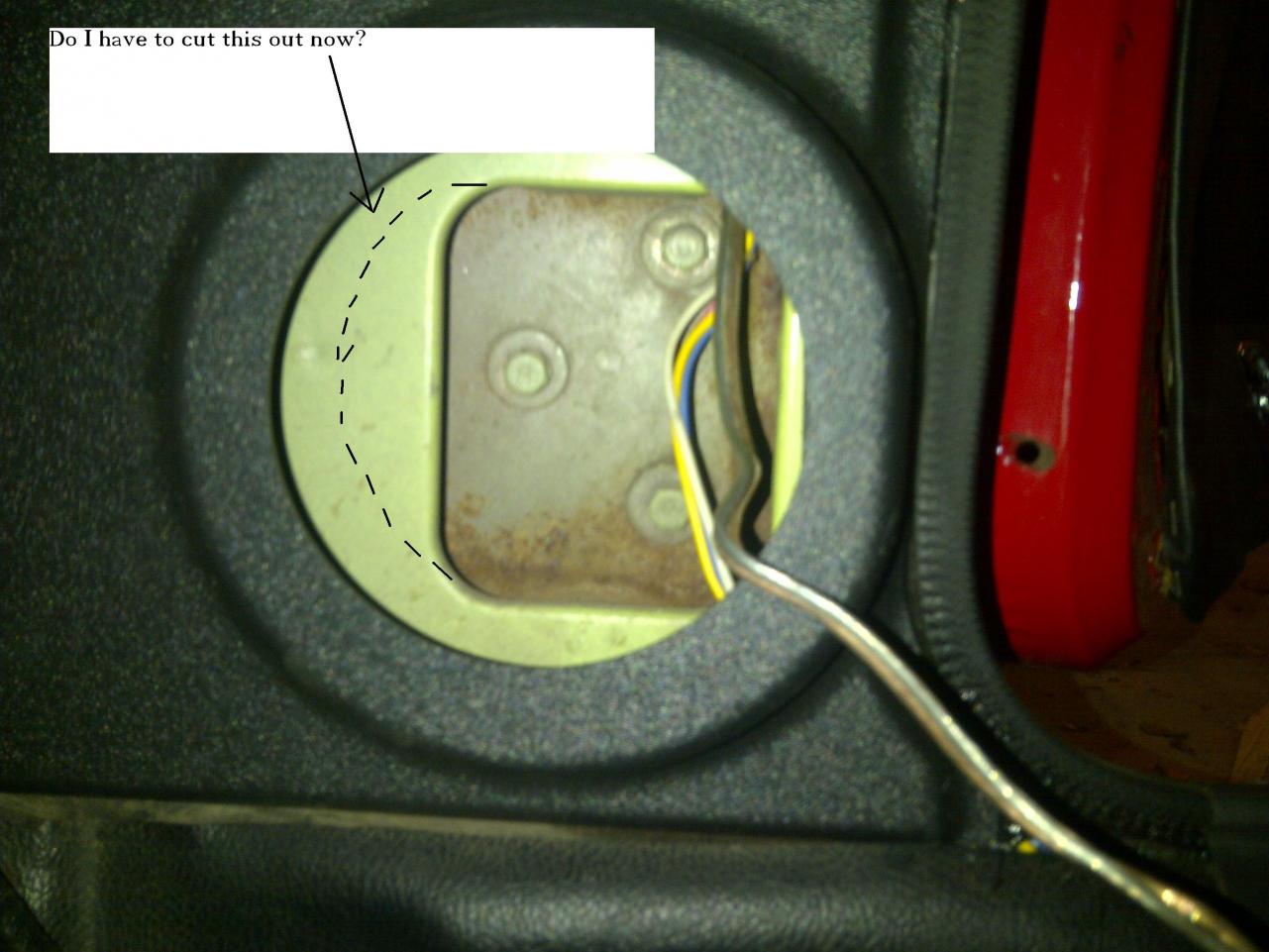

Hmm. Got my Kenwood speakers that Travel'n Man recommended in from amazon today. Went to install them and the certainly don't fit... :mad: I really don't want to cut-away the metal to make these speakers fit, but I don't know what else I can do??
Suppose I have to cut them - any recommendations on how to do it?
Thanks,
John
Hi John
I don't have any specific Ideas. Hopefully Travel'n Man will chime in though.
The speaker magnet is larger around than the frame that it attaches to. Can you angle the speaker and cheat it into the hole. when it's in the hole since the frame is a little smaller than the magnet maybe you can straighten it out.
Just a thought.
Derek
