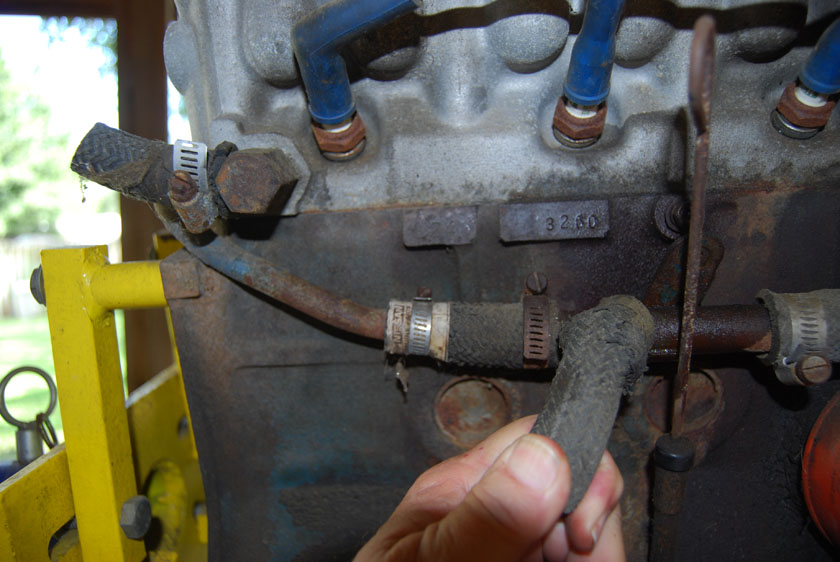

If your heater hose is leaking, you can simply cut the leaking hose and move it out of the way. Then cut the good hose near the firewall and loop it to the connection that the bad hose was on. That will allow you to drive the car home, if your fixing things on the side of the road. You can see the two heater hoses in the picture below {well at least part of the two heater hoses} Or you can buy enough new heater hose at the parts store to form a loop in the engine bay. Make sure you can get the old clamps off, or pick up a couple new clamps.

Changing the heater hoses at the heater core is something that you will want to have some time to do. It's a tight fit up under the dash - and a job best done in your driveway. You may want to order all three hoses from your Nissan Dealer. Two run to/from the engine and one connects the heater valve to the heater core. All three are preformed with fairly tight bends.
Heater Hoses to/from heater core
regulator 27118-N3300
Intake 27181-N3000
Output 27181-N3300
