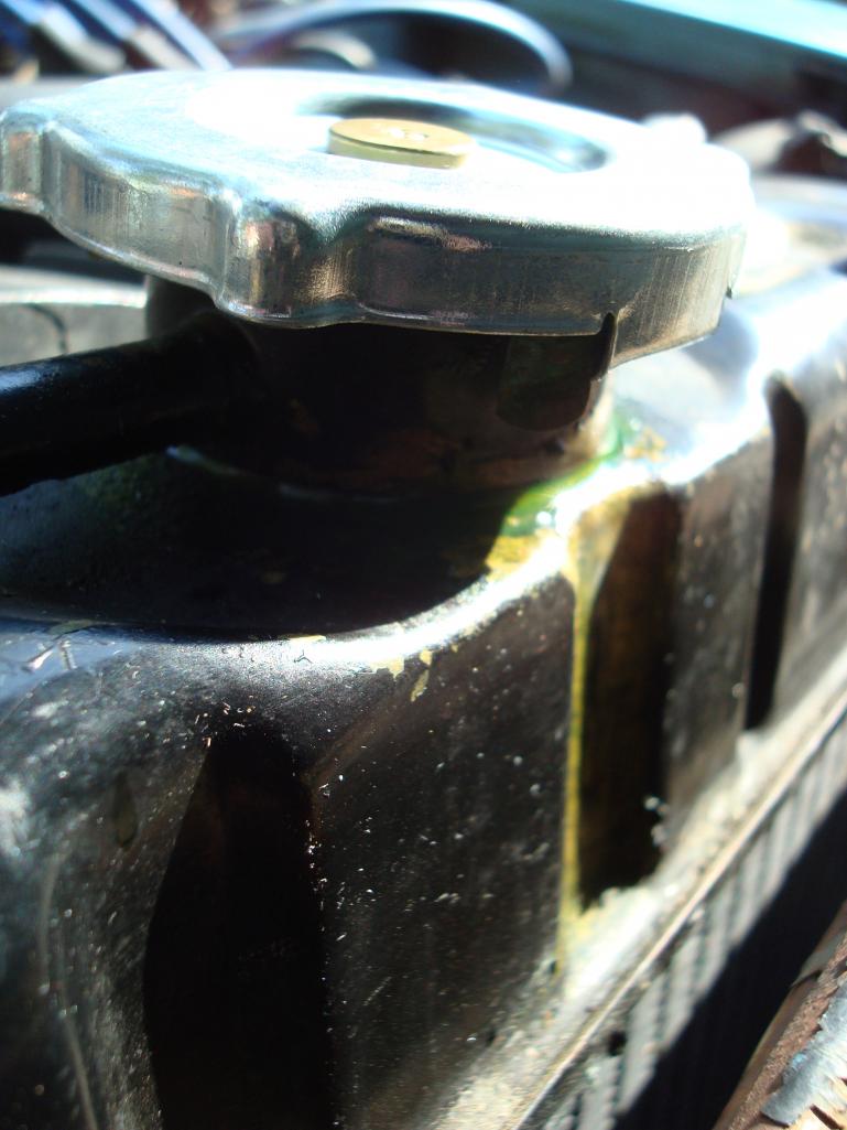

You might want to check your Rad Cap and hoses while you are at it. The problem you describe might also be caused by the coolant system not being able to adequately pressurize.
Thanks, the hoses look good and cap is new, but i do have a slight leak from some where :disappoin
Was this coolant from when you opened the cap? With the cap off wash everything off and blow dry with compressed air. Look for any cracks in the neck on the top tank of the radiator.
You could also take the car to a shop that has a pressure tester and see what bubbles up.
This still might not be your problem, but it is starting to look that way.

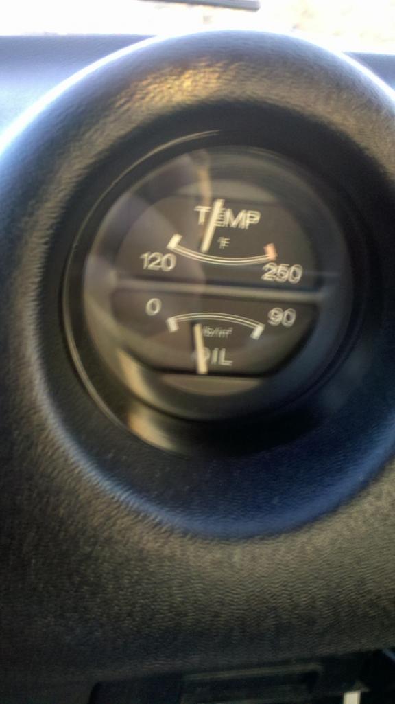

No, this is what accumulates after i drive the car round trip to work. i called around to find the nearest radiator shop that stays open long enough for me to make it into town before they close. i should find out something next week Tuesday. I took a picture of the temp gauge on my way home ( condition o/s temp 58 deg. @ 70 mph ) does this look normal ?
Another possiblity-in the morning,block off half your radiator and see how it re-acts.In my 620 if the temps are below 50, i have to block off half the radiator to get the temp up to 180(with a 180 stat.)ANd with temps in the 70's it'll stay at 180 or a hair above.ANd when i pull the cardboard out,it'll sit like a rock at 180.
I have had radiators where the filler neck, or whatever you call it, was bent down or dented and the cap would not seal completely when the system reached full pressure.
I have seen people use the cardboard trick, but it always worried me that I might forget and end up overheating the car. Besides of the 20+ cars I have owned, I never had one that needed a SMALLER radiator, even when it was bone chillingly cold. If the thermostat is working the radiator size is irrelevant in cold weather.
