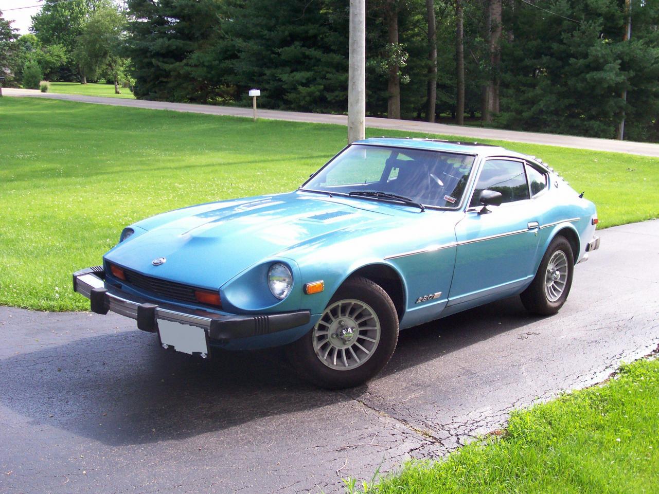

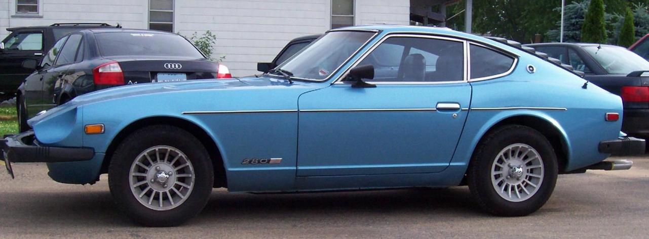

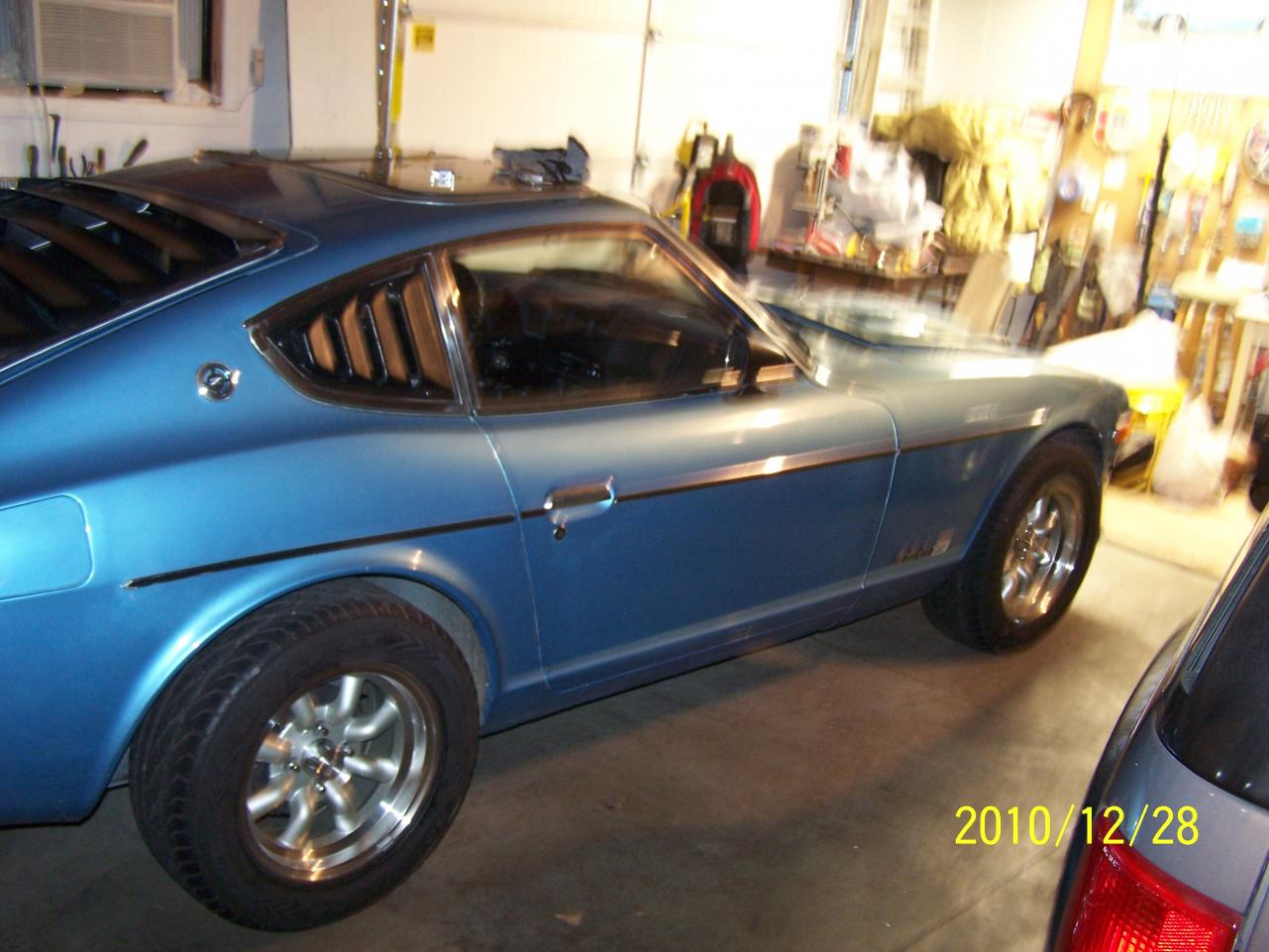

There are some pics I just added. I still have original tires and rims, but all the rims were a little bent, and all tires had flat spots. So needless to say when i got upto 55 to 70mph the steering wheel was shaking a lot. Also, I found out I had bad bearings in the front left side. So once the bearings were fixed, and the new Eagle GT tires and rims...it rides smooth. I like both the old rims and new rims though. But favor the new ones more.

I added a few pictures
argniest,
Reading your posts, you have my curiosity. Can you post some pictures of your Z? We all enjoy pictures of each others Z's and they help others in resolving problems.
Edited by ZCurves
Its *supposed* to be 510 blue. But I bought a new air dam for it, and had the air dam painted 510 blue. Well guess what??? The car aint no 510 blue :)
