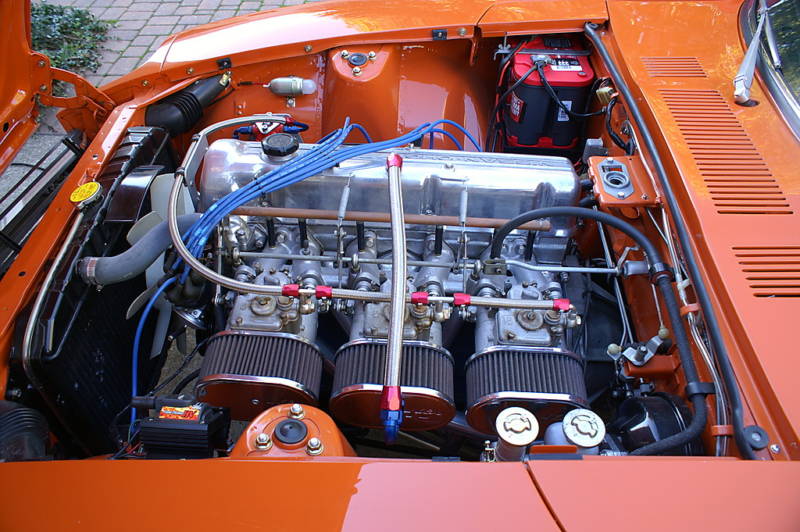

I just measured my set up which is triple webers, cannon intake manifold and K&N filter.
From head to end of K&N filter is approximately 13.75 inches.
K&N filter assembly is approx. 3.5 inches
Cannon intake is approx. 5.5 inches
Hope that helps.

I have triple Webers with the long manifolds on mine. On the Z, I barely have room to get the air filters off the cleaner assembly on a Z. I have to twist and pull at the brake reservoirs. I don't have time to measure right now but I should have some time tomorrow. Did you get a hold of Gary about your engine? That's a good looking car and with L power it will be a torque monster!

I think mine is the long one considering I only have 1.5 inches of clearance between the strut tower and edge of K&N filter.

I have mikunis using a F.E.T. (Far East Trading Co.) intake manifold which is very short compared to most other intakes. I have at least 6" in between the air filters and strut tower.
Thank you all for the replies. I appreciate the effort to take the measurements and post pictures.
