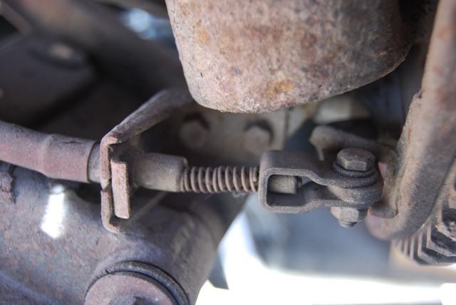

I was looking through a few pictures and in this one, you can see that the washer is weather cracked. I assume that the bushings may not be much better (even though they feel OK).
I guess I will be looking for a spindle pin puller! DAMMIT! :cry: Next, to figure out the wheel bearing situation... :sick:

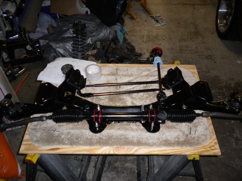

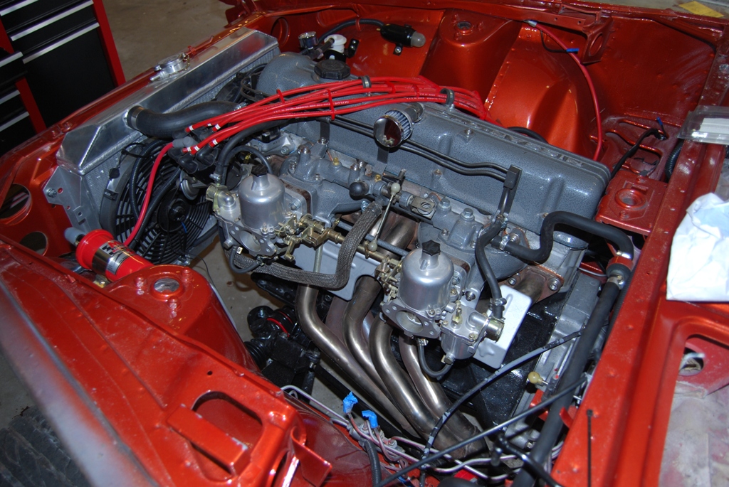

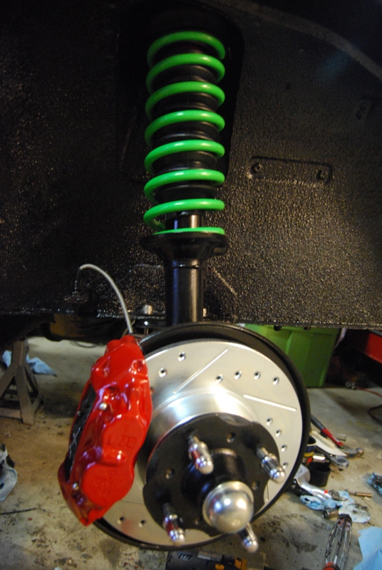

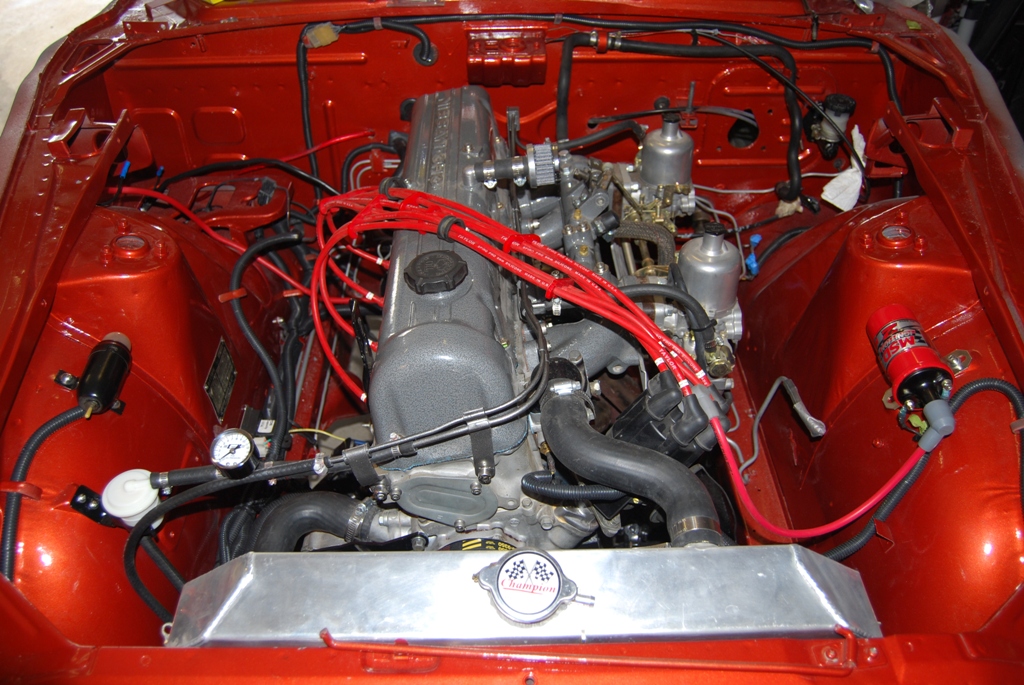

Here are a couple of "progress pics". Still have a lot to do.
EDIT!!!: Needless to say, I am not doing a proper "Original Restoration" on this car, but it should be very nice when I am done... :D
