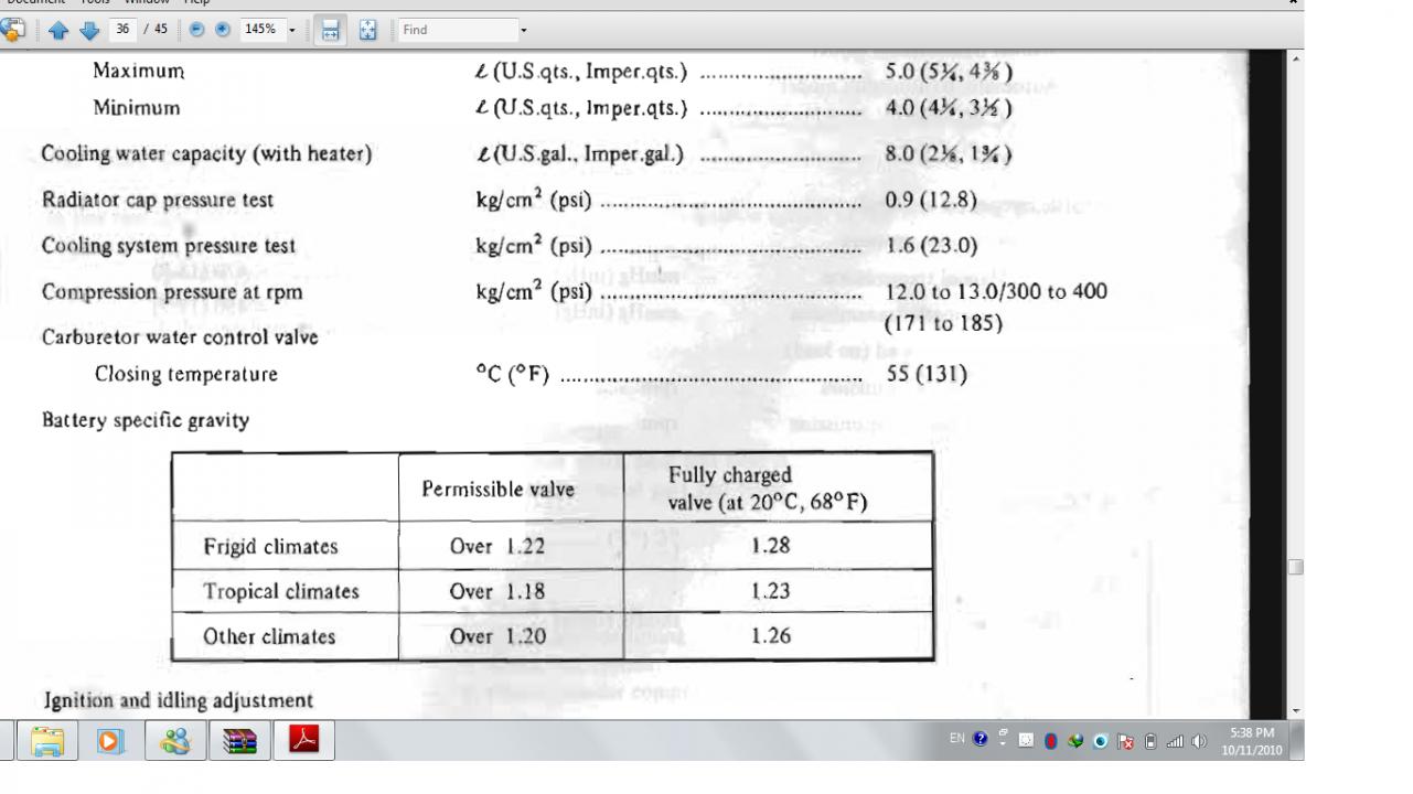

Hi every body this pic may help you, actually it is for 240 but I checked 260z manual and I found it same..
I think your reading is fine its from 171-185 psi
