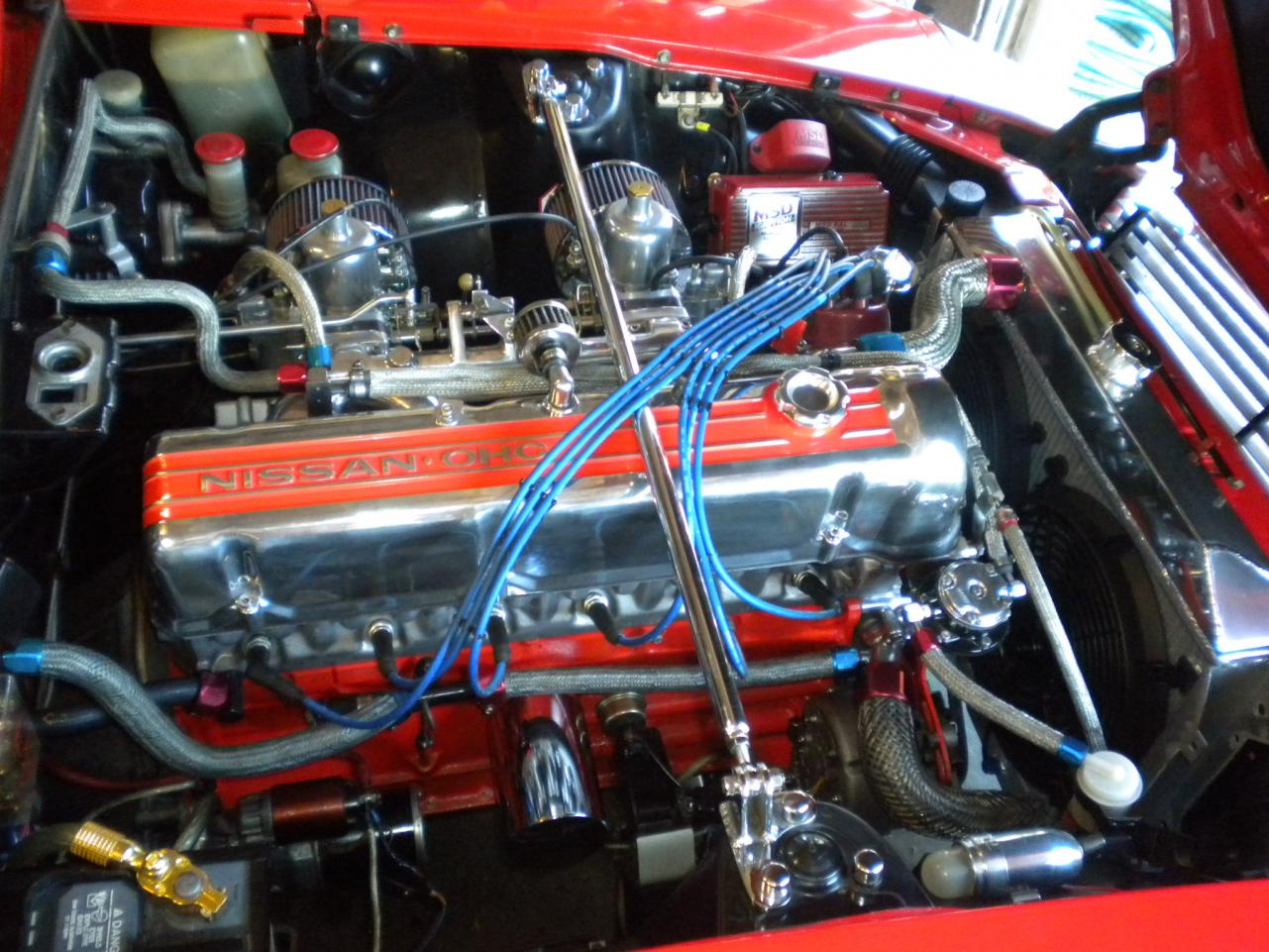

In the picture below, you can make out the silver 8ga wire that goes from the starter to the frame rail, then it goes over to the alternators output bolt.
