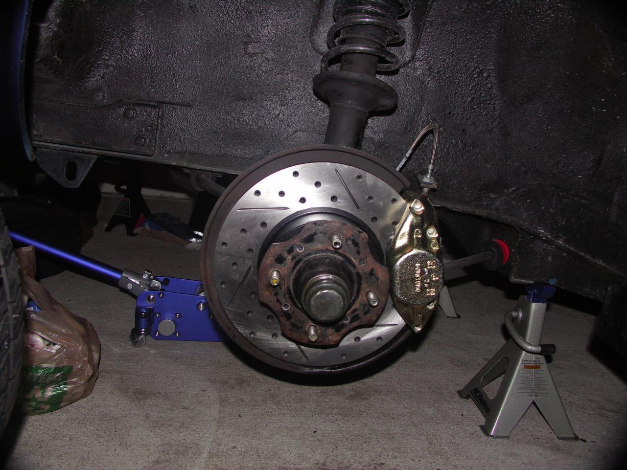

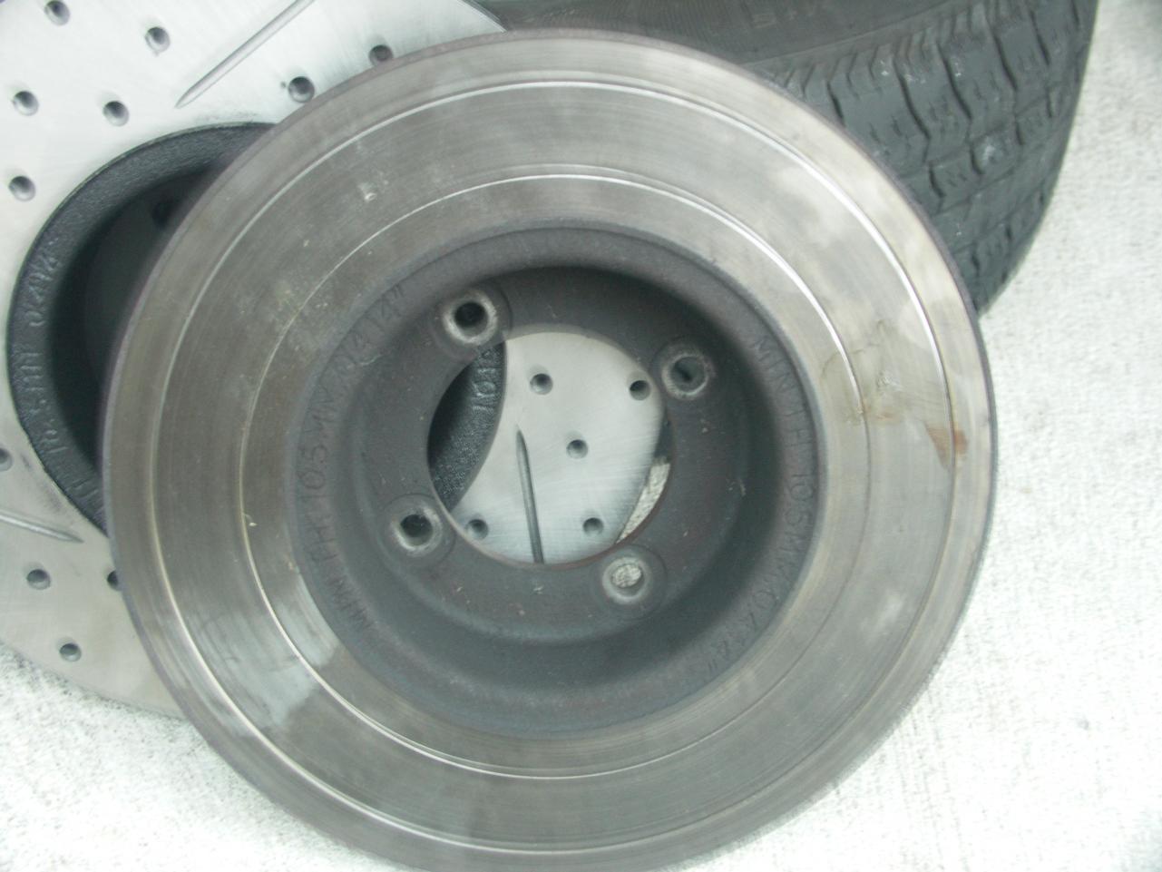

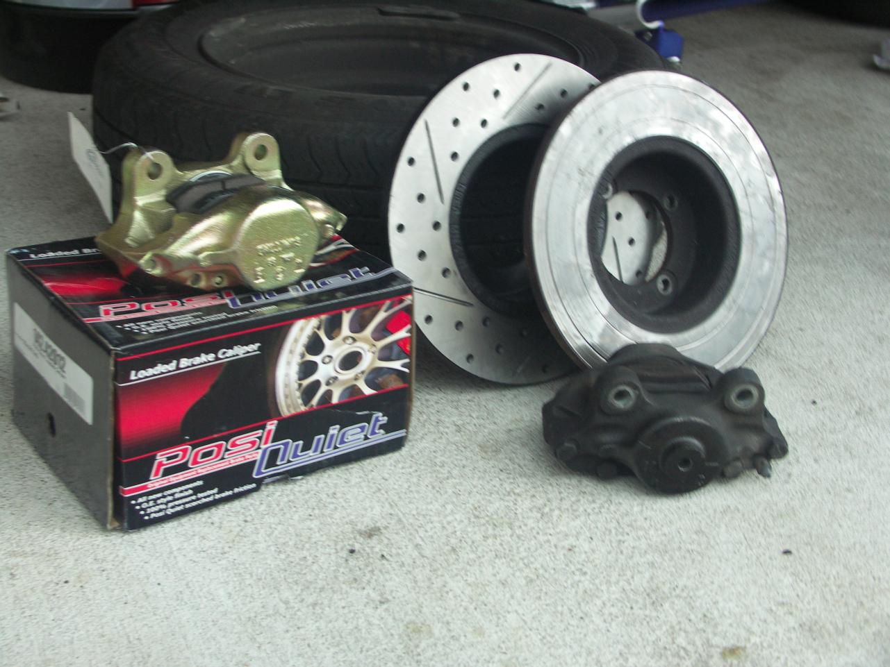

Here's some pictures. Notice that my old rotors had two circles cut into them. What are those about? The circles are on both sides of both rotors, and were so perfect that I think they were there on purpose and not a result of pads wearing out and the backing plate cutting the rotor. I'm speculating they were done to decrease brake dust. Anyone else seen this?
