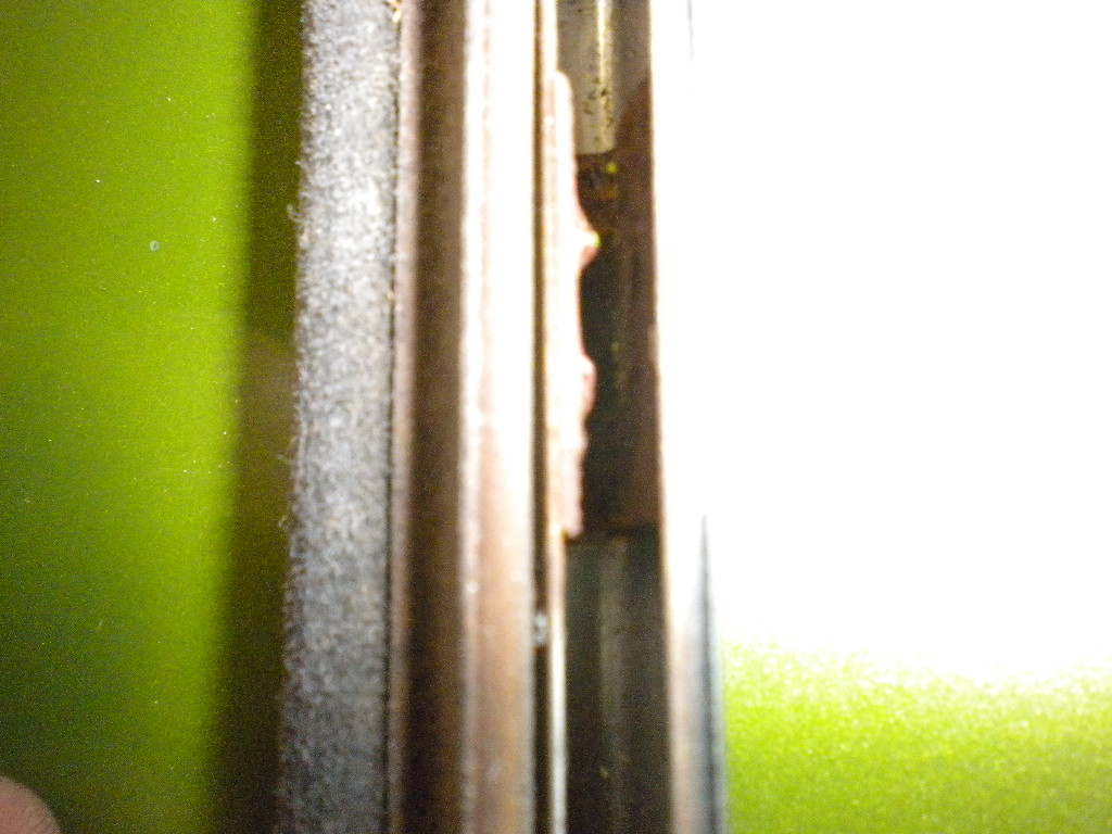

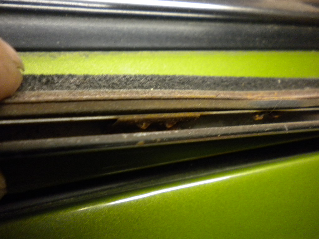

May 5, 201015 yr comment_318407 I tried to get a few shots of the 2 teeth that are supposed to be in each of the 4 or 5 clips. Link to comment https://www.classiczcars.com/forums/topic/35777-bottom-of-window-opening-stainless-strips-fall-off/#findComment-318407 Share on other sites More sharing options...
