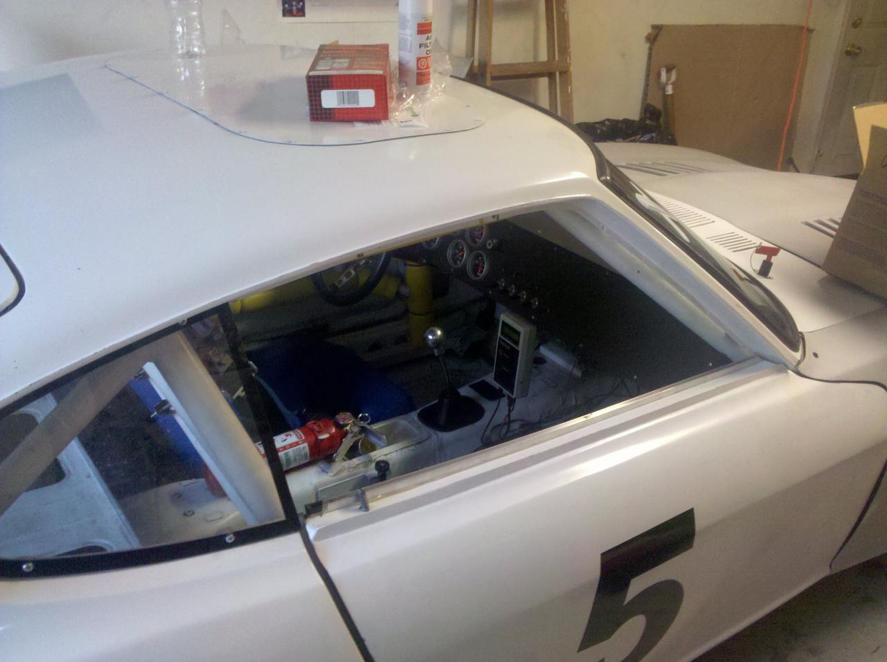

April 28, 201015 yr comment_317558 Can you post a picture of the door even without the new mods I have some ideas but I need to know what you have first? I'm thinking a frame you mount the Plexiglas to, and make the frame and the Plexiglas one piece. I used Plexiglas in my first car 84 200sx it took a little to make the side windows work. Plexiglas needs support around the sides otherwise it will crack, you also want to make it easy to get out to replace it.It might cost more, but how about using polycarbonate, you still will need some support but it is a lot stronger? Link to comment https://www.classiczcars.com/forums/topic/35688-temporary-windows/#findComment-317558 Share on other sites More sharing options...

April 29, 201015 yr Author comment_317623 Can you post a picture of the door even without the new mods I have some ideas but I need to know what you have first? I'm thinking a frame you mount the Plexiglas to, and make the frame and the Plexiglas one piece. I used Plexiglas in my first car 84 200sx it took a little to make the side windows work. Plexiglas needs support around the sides otherwise it will crack, you also want to make it easy to get out to replace it.It might cost more, but how about using polycarbonate, you still will need some support but it is a lot stronger? Here is what the window opening looks like. I installed a 1/4" aluminum channel on the top of the door. I had the plexiglass slid into that and attached to the weather strip lip at the top. I made it long enough that it would lay on top of the quarter window piece. Any and all ideas are welcome. Thanks, Marty Link to comment https://www.classiczcars.com/forums/topic/35688-temporary-windows/#findComment-317623 Share on other sites More sharing options...

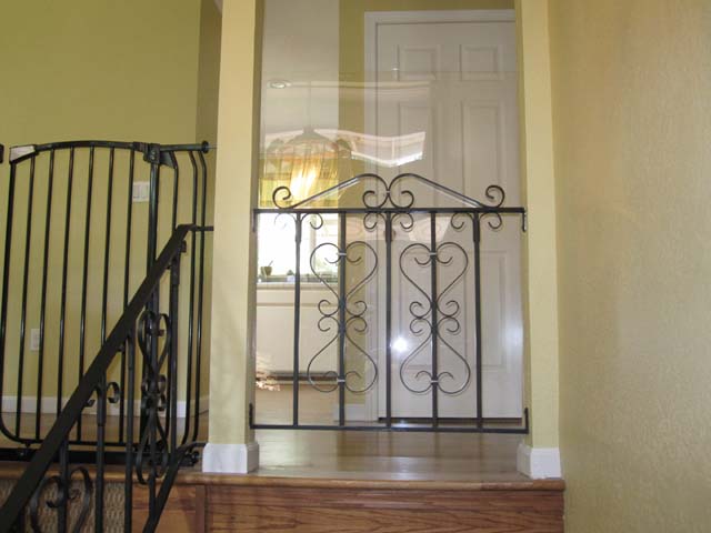

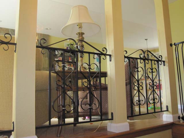

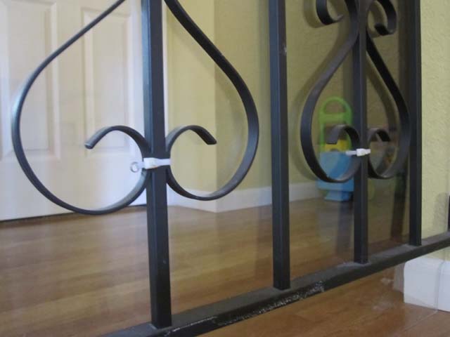

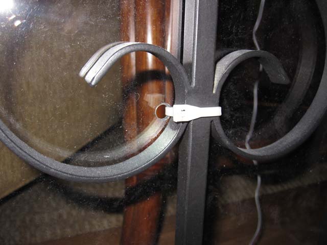

April 29, 201015 yr comment_317653 So how do you cut Lexan? With a jigsaw, sawzall, hacksaw, bandsaw, etc. It's really easy to cut and drill holes in. REALLY easy. Cuts like a very soft wood. Clean up the edges with sandpaper. I recently used some in my home, below are some pics. I have a two year old who liked to throw toys down the stairwell and was starting to climb the banisters. I installed Lexan everywhere she is able to get to. Just took a 4' x 8' sheet, cut it wide enough to fill the space between the columns, actually notched around the base boards with a jigsaw, drilled a couple holes and zip tied it to the wrought iron. No, I didn't have any black zip ties... Lexan is the GE brand of polycarbonate. You might also find it under just polycarbonate if you're looking at a local plastic supply. Link to comment https://www.classiczcars.com/forums/topic/35688-temporary-windows/#findComment-317653 Share on other sites More sharing options...

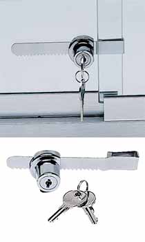

April 29, 201015 yr comment_317668 Cut some Lexan in the exact shape of one of your side windows, slide it up into a small channel at the top of the window opening in the body, and use on of these to hold it in place at the door top. Link to comment https://www.classiczcars.com/forums/topic/35688-temporary-windows/#findComment-317668 Share on other sites More sharing options...
