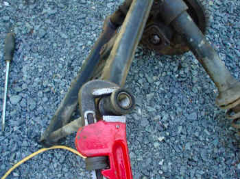

My question lies with the inner and outer bushings. One set slides off very easily, the other side seems to be stuck pretty good. I got a pic off of Atlantic Z where the guy uses a pipe wrench to twist it off (with rubber intact.) I simply sheared the rubber part of the bushing off attempting this.
Any suggestions?

I had to cut the inner sleeve to get it to come off. You have to be very careful not to damage the shaft. I only cut about three quarters of the way through and then split the inner sleeve of the bushing. Right side was the worst.
