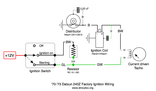

Could be several problems, lights not working and tach pegged at 8K is clearly wrong, so i would start checking the electrical circuits, then check the advance at idle with a strobe gun and then look for vacuum leaks. From what you describe, i would second Tyler, the timing may be too advanced or retared, probably because the distributor was not set with a timing light after installation. Have added a wiring diagram of the ignition which might be helpful.

and as far as i know everything is hooked up right except those two stray wires. the black wire kills the engine when touched to the neg. of the coil and shows system voltage, the green shows nothing and doesnt do aything. i thought maybe the tach was put on the pos. of the coil instead of the negative but we got it to where the only wires on the coil were the run and start power wires, and the ground. and everything was the same driving wise so theres a few wires on there that seem useless. oh yeah and one of them is tied to the stray black wire and if its off the black wire has no power to it. if anyone knows what these wires are that would be cool. i looked at a 72 wiring diagram and i couldnt figure out which ones were for what LOL
