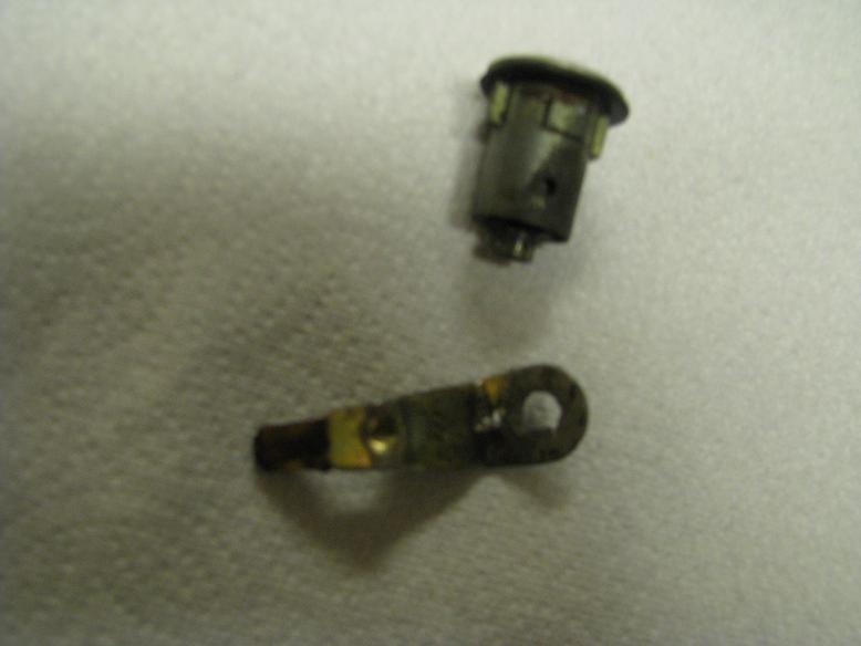

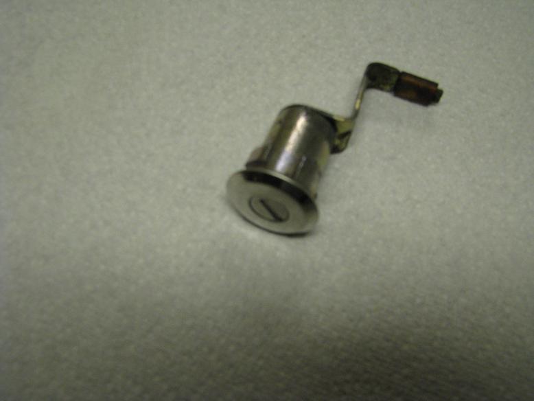

First pic is of the lock assembly with the lever attached.
Second pic is with the lever detached.
The third pic is blurry, but in the center of the hole is a tab. That tab gets worn down to the point it won't catch on the locking cylinder when the key is turned. You probably just need another lever.
BTW, the lock cylinders on the drivers & passenger door are identical. It is the lever that is different for each side.

Geoyam, I tried using a shim (washer), but in my case, it wasn't the cylinder that was worn, it was the little tab on the lever arm itself. I replaced the arm, and the lock works as new. Nice pics & details though.
