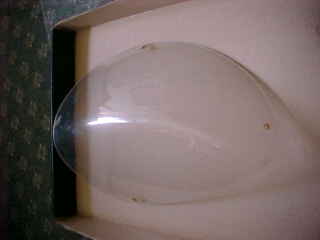

How do they install without drilling?
OzLime240Z
I have attached a picture of a plain perspex LH cover for an idea. the rust marks are the screw attachment points, right angle bracket are attached to the headlight bucket at these points sitting on plastic isolators with self tapping screws securing them. there is also a dust seal that goes around the rim of the perspex. you place the cover in position nad use self tappers to attach the cover to the brackets(trick for young players use stainless steel screws and brackets).
