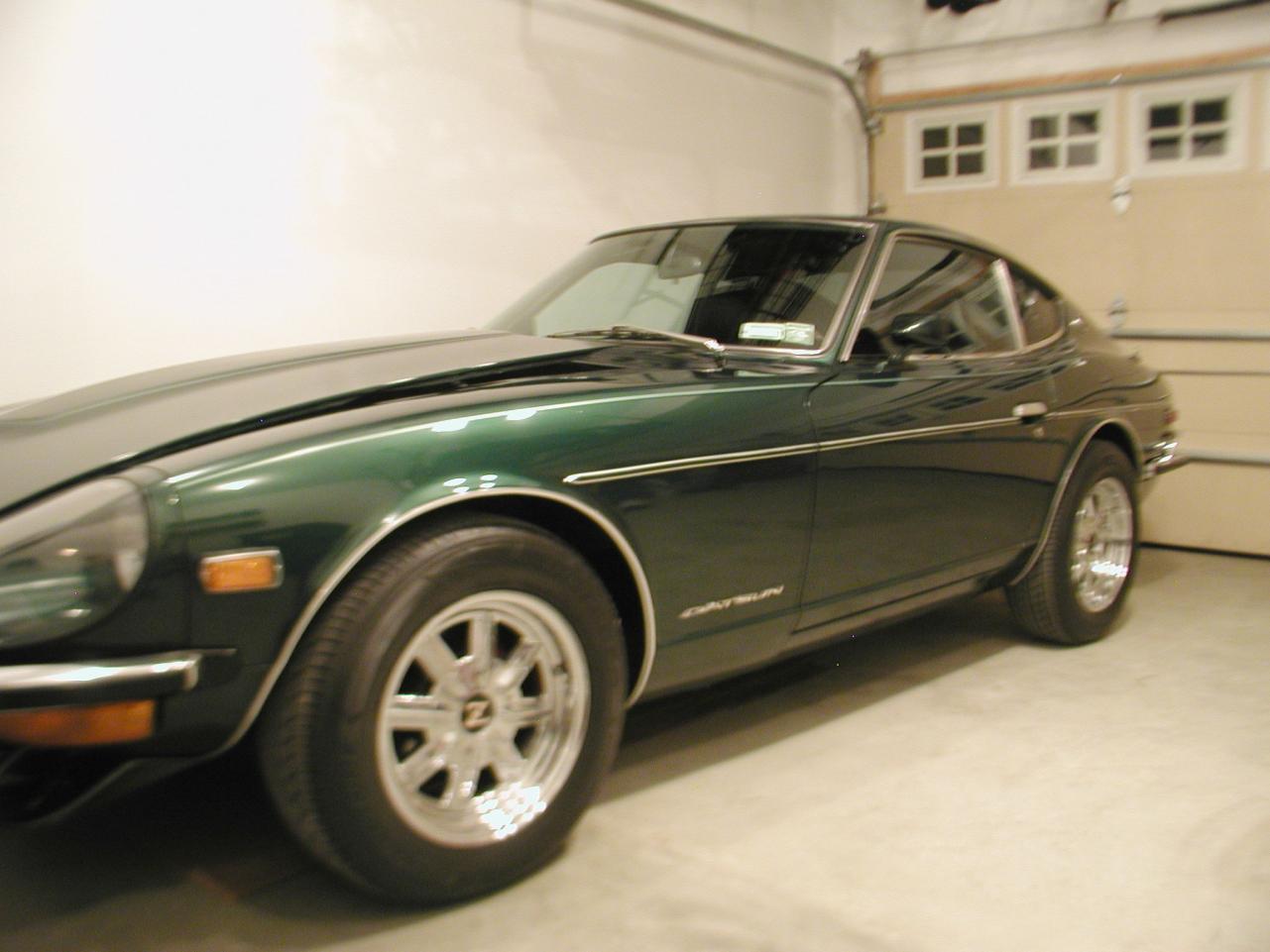

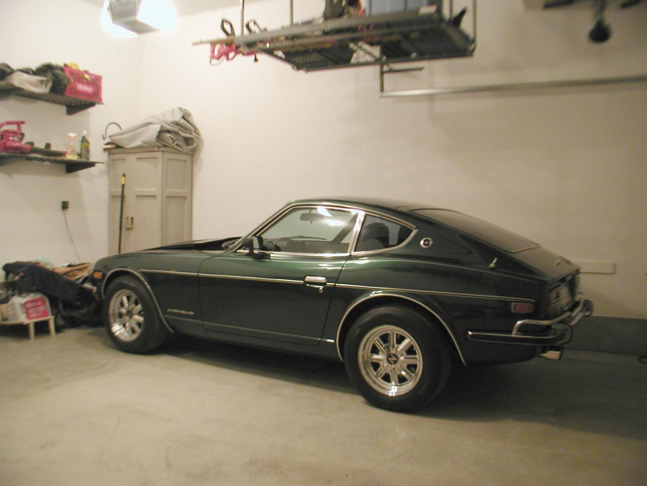

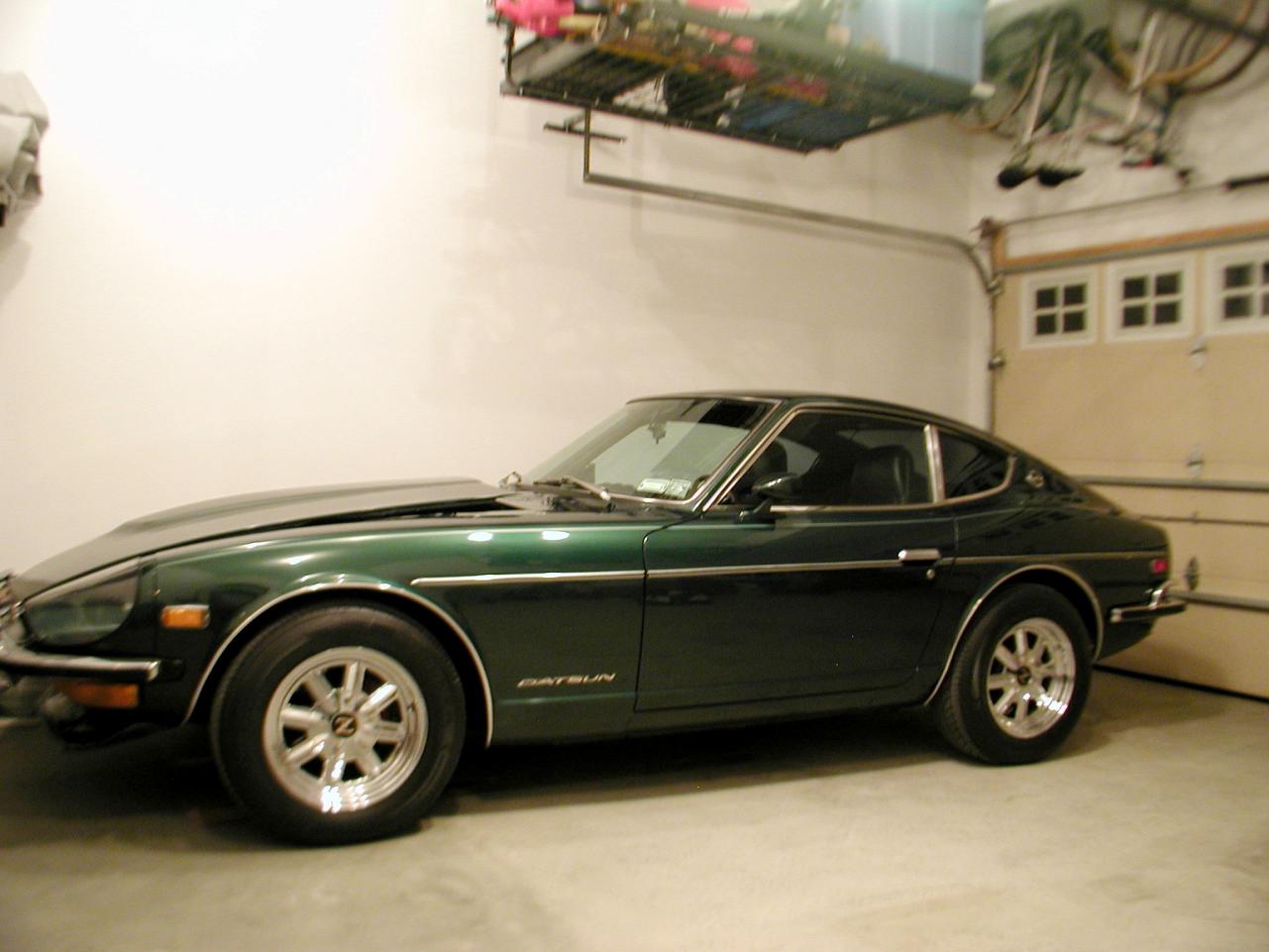

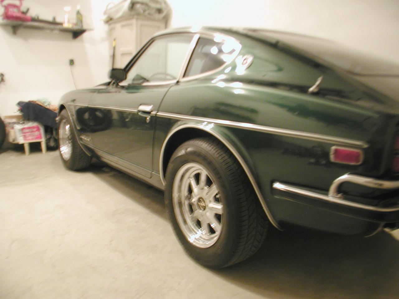

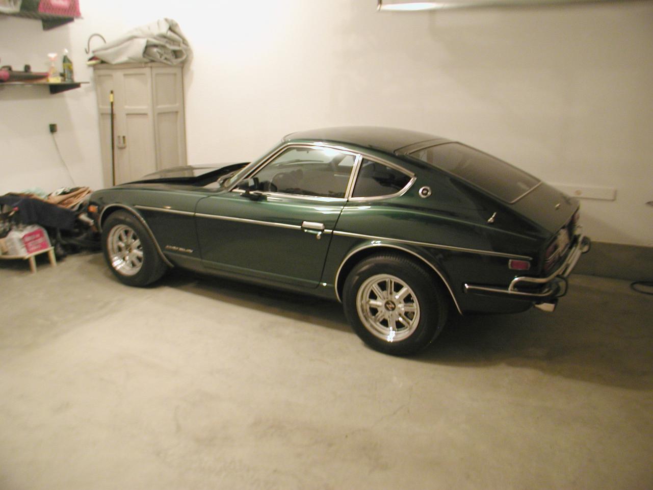

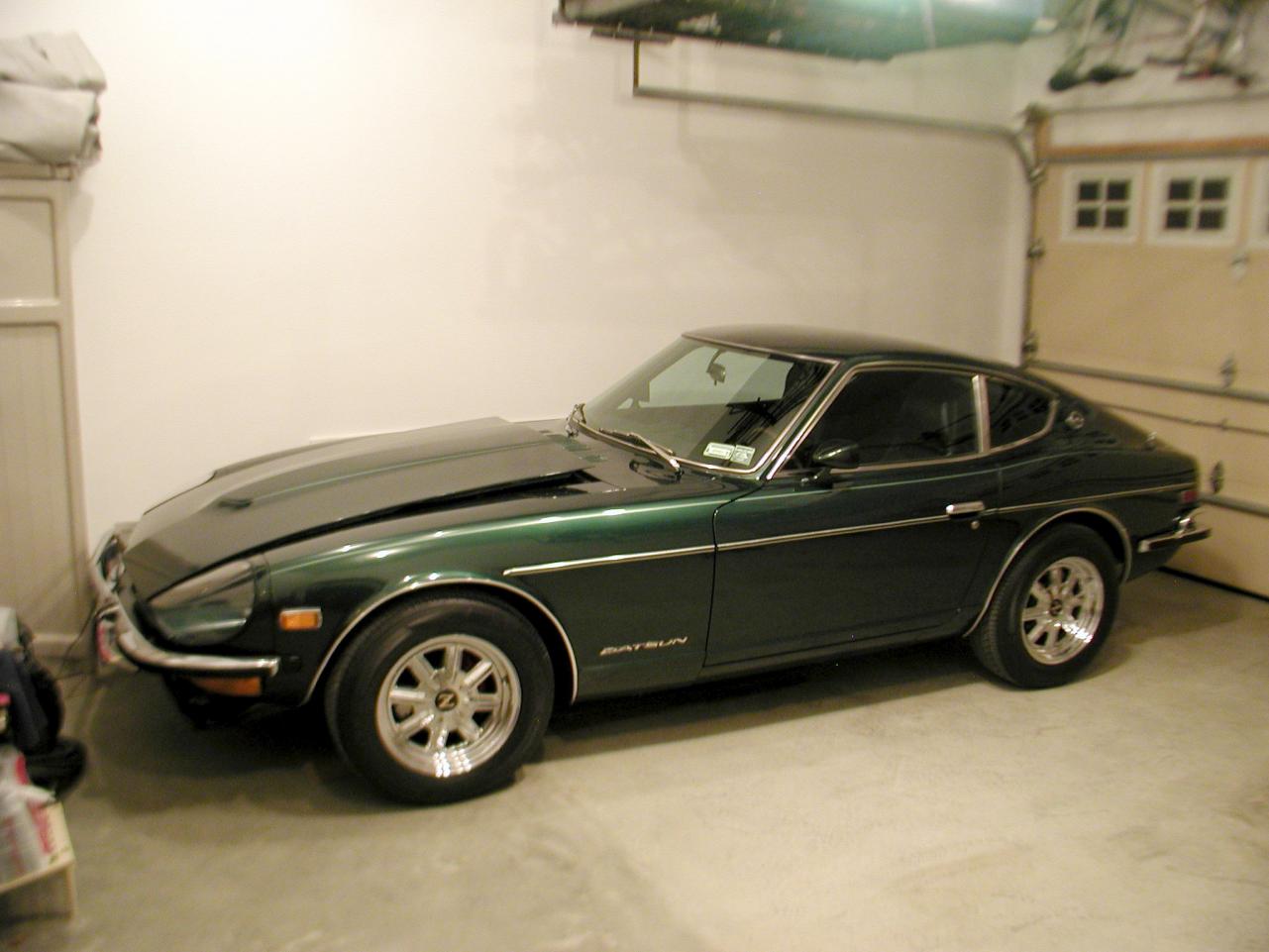

I really wanted my car to sit with the front 3/4" to 1" lower than the rear to keep the nose down when cruising on the highway. It turned out pretty close. The photos below reflect my recent installion with just about 10miles on the car. It may settle a little more over time.
