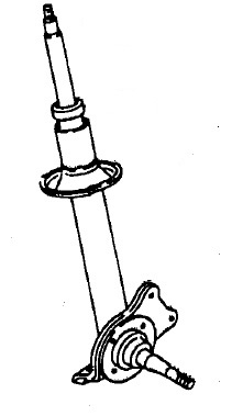

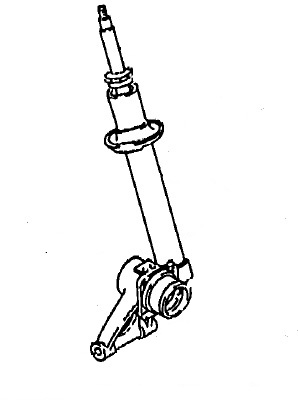

From a manufacturing viewpoint, the S30 chassis (240/260/280Z) will take a huge investment to build what you refer to as "true" coil-overs. Both front and rear strut housing on these cars have integrated, forged and machined suspension and brake mounting bosses, plus the front includes the spindle and the rear includes the wheel bearing housing. No way to do reproduce this in small numbers. That's why all coilovers for early Zs have been sleeve kits, because the other way isn't economically feasible in anything other than mass-production quantities.
