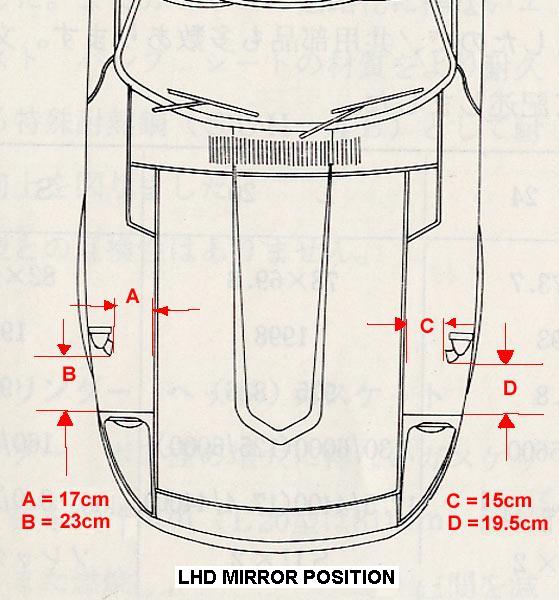

Drilled and installed . Looks like the measurements were it, but the mirrors don't really give a great vision but it's ok. Thanks guys.

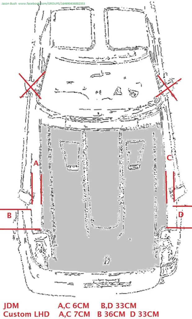

Not attempting to hijack this thread... :bunny:
...but :stupid: I made a corollary image for the Datsun 280ZX that I'd like to get picked up by the Google search engine. LOL
Also, this thread is easily hit on multiple search engines and anyone researching fender mirrors for the Datsun 280ZX will pass through here with the template from Google Images.
Datsun 280ZX Fender Mirror Template S130 Body
