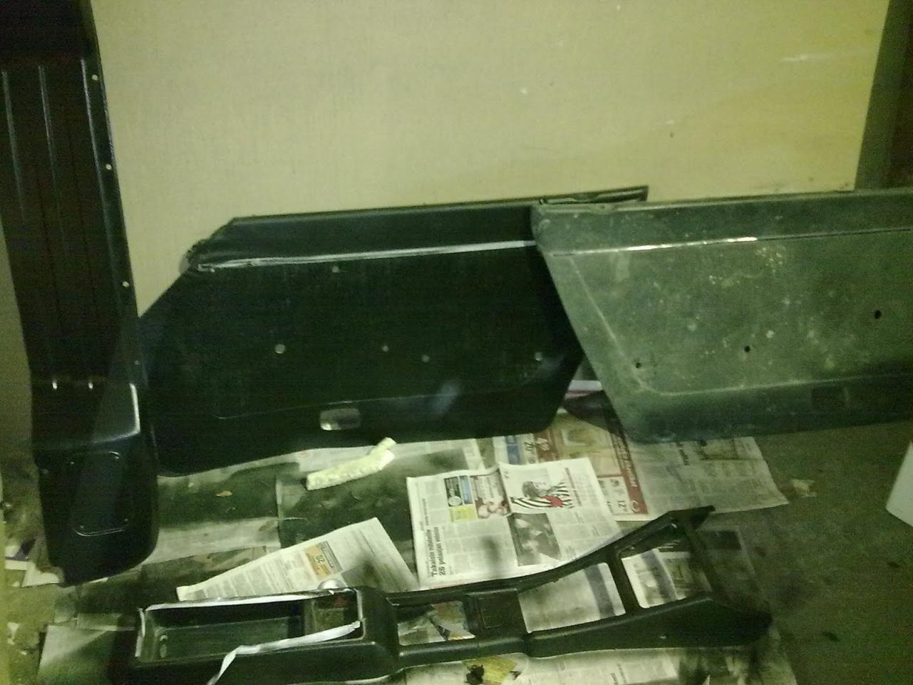

See the difference in before and after. VHT spray is good but it's hard to get a steady paintjob with it. I've sprayed at least 3-4 coats on each item.
Now i just need to figure out how to repair the plastics, theres lot of holes and cracks on them, maybe its easier to order new ones..
