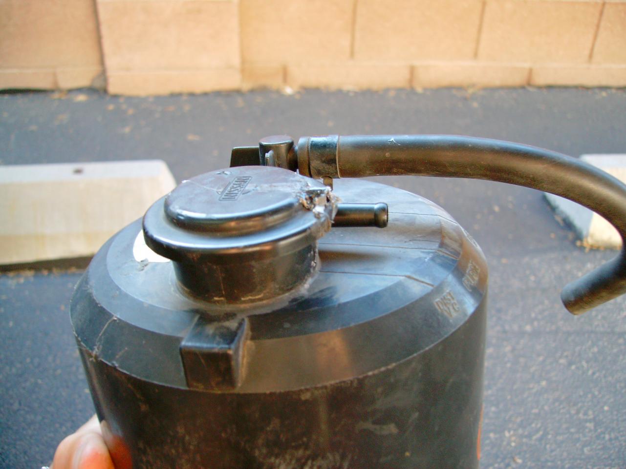

Did a search on this but didn't find my exact problem. Yesterday afternoon I was replacing my alternator belt. While removing the carbon canister I happened to hit it against the fender wall and knocked off the little nipple that holds the vac line that goes to the distributor. I tried gluing it back on but it hasn't really worked.
1. Does anyone know where I can get just the top piece. In the manual its called the diaphram cover.

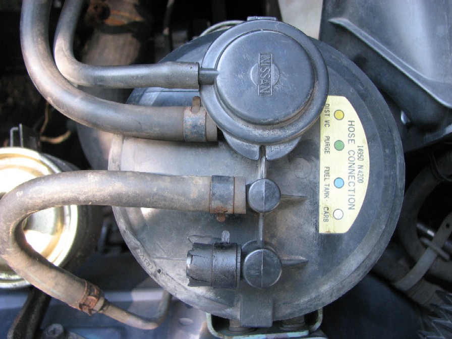

Would you be making reference to the "Nipples" on the top part of the carbon cannister...see picture attached...

Yes I referring to the very small one that goes to the dist vc. Broke it completely off. Glued it on but the glue isn't holding all that well.

So what's with this large tube you mentioned coming out the bottom of the carbon canister..?? Have a picture by any chance..?? Should look approx like the picture attached...might be able to still get the cap from your local Nissian dealer...see if I can dig up a part number for you unless someone just happens to have it handy...
webdawg1
Found the part number for the cap...14964-F1700...appears to be a good number still...(about $3.00-4.00 bucks) Would check with your local Nissian dealer and see what you can turn up...you would be amazed at what you can still get from your local dealer when you walk in with a part number in hand...

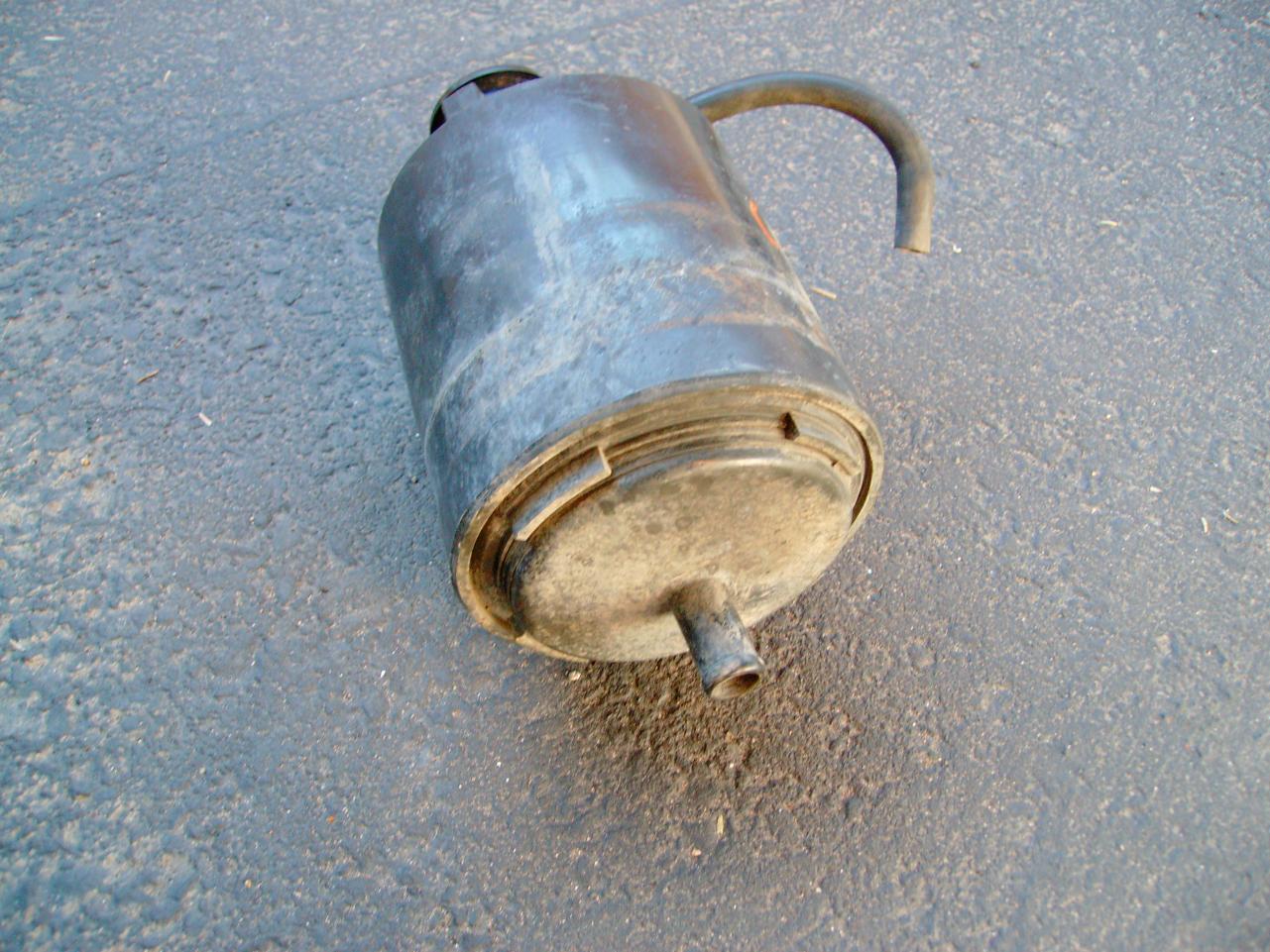

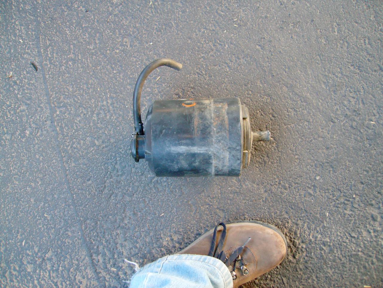

Here is a pic of the carbon canister I have. It looks nothing on the bottom like you showed webdawg1. The first two pictures show the actual canister and the last is the part I broke. What are the dangers of driving with the dist vac line unplugged as the gluing job didn't work.
I'm thinking that this isn't the right canister for this car. It would explain the fuel smell when driving. Are carbon canisters in the Z's interchangeable with ZX or anything else?
