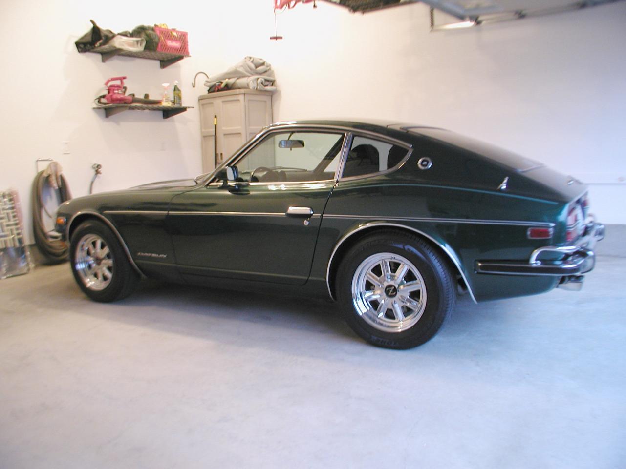

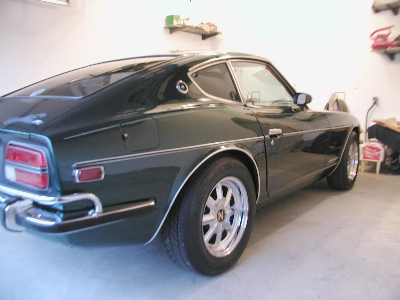

Hope this helps some for you.... here's a couple photos of how my car sits.
I do have 205/65/15 Tires - Bridgestone Potenza Pole Position.. I like them as they are a good balance between comfort and handling. They are for summer driving and have directional rotation.
Edited by moritz55
My rims are 15" x 7.5" MSA (MotorsportAuto in CA)chrome wheels from about 12 years ago or so and came with the car when I bought it. The center has a cap with the "Z" logo stuck on it, such that it covers the lugs. Up close the chrome is a bit dinged up.
My tires as I mentioned are 205/65/15 Bridgestone Potenza Pole Position directionals. They are significantly better in comfort and pretty good for handling than my BFG g-Force Sport 205/60/15 tires that I had and far better than the Yokohama 205/50/15's that came with the car. The BFG tires were loud and very hard - nice for handling but terrible for comfort. These BFG tires were also slightly undersized so my speedo was off, that's why I went to the 65's. Also the 65's gave me more rubber between the rim and road for some improvements in comfort. My tire size today is just a little larger than stock (~1/2" in diameter larger in total) so my speedo measures ~1.5 MPH slower than I'm actually going at 60MPH. Somewhere in this website I read the stock tire for a 240z is 175HR14 I think... which translates into 170/82/14 equivalent size. Many use 195/70/14 tires if they have 14inch rims. Here's a good website for Tire dimensions & conversions: http://www.discounttire.com/dtcs/infoTireMath.dos
