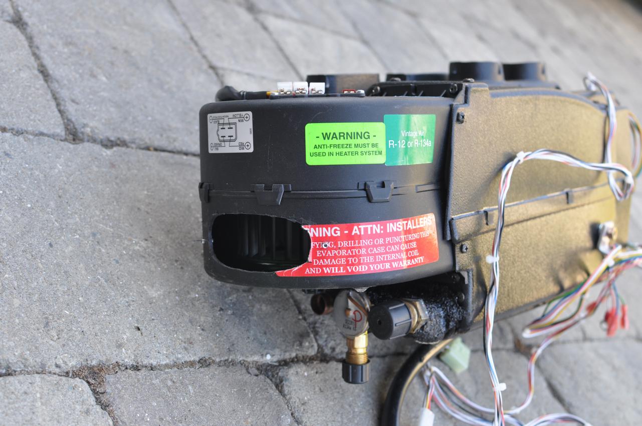

First thing I needed was a fresh-air inlet into the squirrel cage fan. That was easy, just cut a hole and invalidate the warrantee on my evaporator. (see pic)

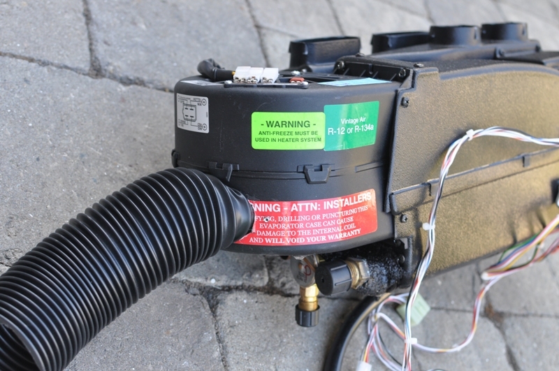

I started by making a plenum to attach the hose, but found it worked just as well to insert the hose in the hole. (2nd pic).

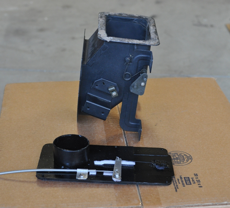

The vintage air unit was too long to fit the stock fresh air valve. As a result, I needed to make a “low profile” assembly to replace it. Attached is a pic of both old & new valves.
I cobbled-together a sliding gate valve using stuff already in my garage and with a few items from the local Ace Hardware. It’s constructed from 1/8” acrylic sheet, 1/16” fiberglass sheet, 1/16” aluminum, epoxy, rivets and some self-adhesive, fuzzy pad material.
The aluminum bellcrank allows the 2-1/2” diameter valve to open/close fully with only a 1” push/pull of the cable.
It operates smoothly, doesn’t rattle and is actually more air-tight than the original flapper valve assembly.
I admit it's not "pretty", but since it’s hidden up above and behind the glove box, it’s not visible.

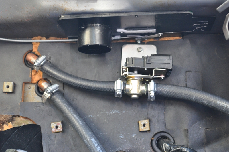

Attached is a picture of the new valve installed in the car, along with the Vintage Air remote heater valve. I used 3M exterior mounting tape to attach the unit under the dash. It’s rated for exterior automotive use and more than strong enough for this application.
Also, you can see that I have installed elbows at the firewall on the heater hoses to allow a tight 90 degree turn without crimping the hose.

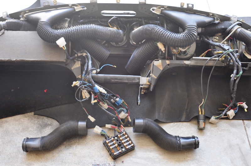

Next are the dash & ducts. The original heater ducts would not mate easily with the vintage air unit.
Happlily, the heater ducts are a two-piece assemblies. I simply removed the end that attaches to the heater and the 2-1/2 ducting for supplied by Vintage Air happened to be a good slip-fit over the existing hoses. A little duct tape to assure an air-tight seal and those were good-to-go.
The defroster connections and hoses are the same size as the stock Z parts, so no problem there. Attached is a pic of the ducting installed in the dash.
I still need to fabricate an adaptor for the center vent, but that should be very easy. I’ll post a pich of that and the controls set-up in a couple weeks.

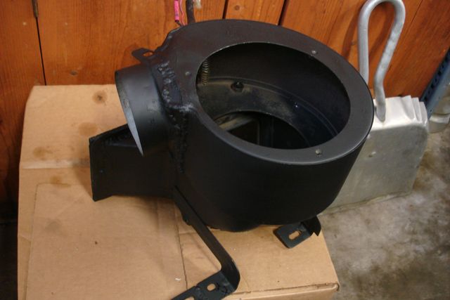

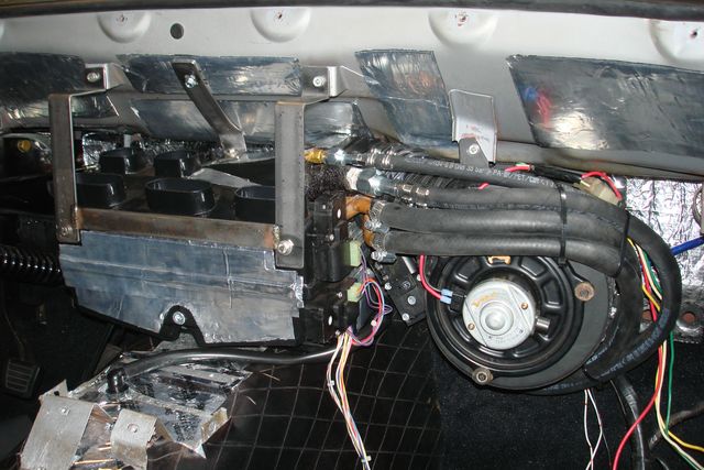

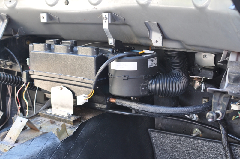

I installed a vintage air Compact (gotta love servos over cables) into my 240Z. It works fine but the center vent is severely restrictive by the OEM design. I hope to correct that somehow someday. Here are a few photos showing how I incorporated fresh air. The stock fan housing was modified and relocated 2.5" over. The vintage air fan was removed and the heater core piping was modified to clear the fan assembly.

Nice!
I thought of trying to keep the OEM air valve, but didn't think of switching-out the fan the way you did. Good idea!
