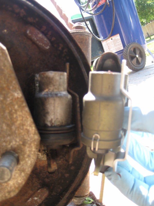

I pulled off the front and rear suspension this weekend so I can clean it up, send it in to get the bushings changed out, and replace anything that needs it. I have a set of brand new rear wheel cylinders in a box. The ones I have look ALMOST the same as the ones on there. The ones I have have a 'pointed' rubber surround and the line goes into the top. The ones that are on the car the rubber surround is 'rounded' and the lines go in the side.
I included some pics. My question is, are these interchangeable? I need to replace one of mine, its all seized up and rusty. If they aren't can I make them work or change some parts from the good one?

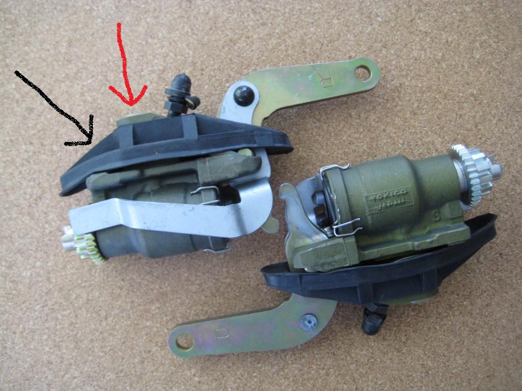

Thanks Carl and Ron. I dont have a box with part number, they were in a bigger box of stuff. Heres a pic. All they say on them is 7/8 and Tockico (theres an 'E2' stamped on one and a "01J" on the other)

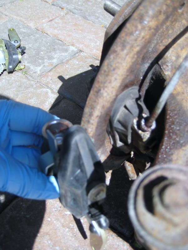

The red arrow is where the brake line goes in this new cylinder. The black arrow is where it goes on my old one on the car.
I cut the hard line and the rubber line as I plan on replacing them both, the hard line that was on there was just kind of made to fit, it does not look like a pre-formed hard line as it was kinda wrapped around everywhere. What does a '73 hard line look like? does it go around the mount for the control arm or up thru that mount?

Only problem I can see is that you have 2 right hand cylinders. They are handed L & R.
Hi Zak:
The hard line for the 73 is pre-formed, and it is made to fit the inlet on the 73 wheel cylinder. Off hand, I can't remember the routing of the hard line... I do know that some time ago the 70/72 rear wheel cylinders were NLA - and the only way to get replacements was to use the 73 wheel cylinders with the 73 hard lines.
Seems to me that the last time I tried to order the hard lines one or the other side for 73 was NLA also...

Thanks again guys, I took these in to the local Datsun mechanic today and he said at first I had 2 right hand cylinders due to the R stamped on them. But the are mirror images of each other and after some debate between mechanics it seems they are L and R, but one has an inverted R lever. Worst case I re-use the L lever from my old ones.
They said they can bend me some hard lines for them also.
