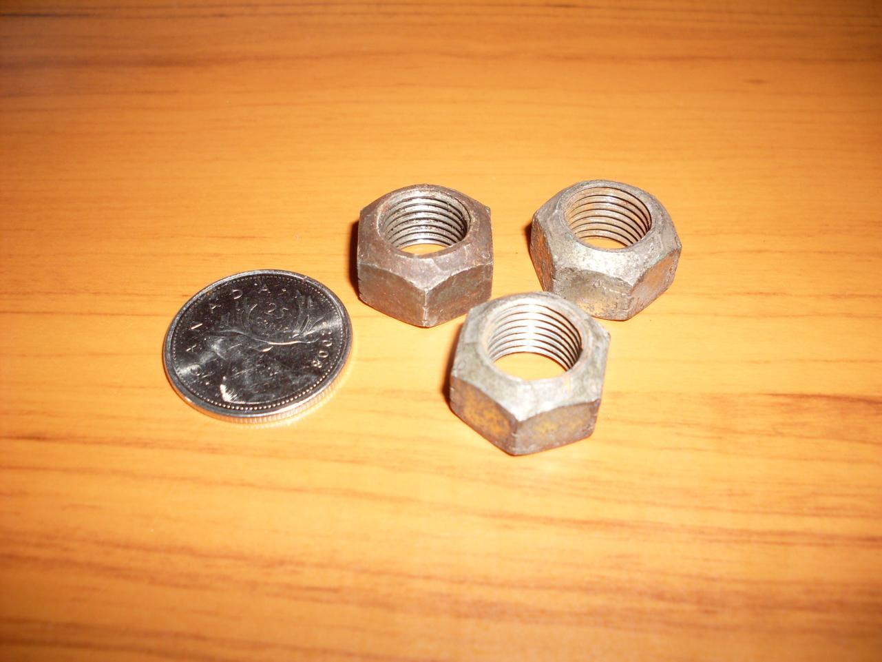

I know I have a set of Mullhollands in my garage. I walk past them on the shelf every time I go in. I'm pretty sure I have the gland nuts on them. If they are there you'll just have to pay for shipping from Moncton, NB, Canada. I can always machine some if I ever wish to use the inserts.
I'll check in a few hours and let you know.
Edited by Jeffrey
I'll gladly pay the shipping if you have them and are willing to part with them. Let me know. Thanks.
I found three in the garage. Just to be sure these are Mullholland strut inserts that came out of a 240z. The inserts are orange and are probably 80's vintage.
Here is a picture.
So you only need two? Send me your mailing address I'll get them off to you tomorrow.
