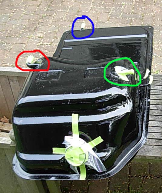

May 23, 200916 yr comment_284526 This thread got me to use the search feature to find out why when I fill my 73 I get a leak....but only when the tank is full after I burn off a gallon or two it no longer leaks. I could not find any former talks of that using the search....it also leads to fumes in the car too of course. I seems to be leaking from the top of the tank and not any of the sides. Opinions? or shoud I search with the search feature more? Or did I just high jack? There are three braided hoses that mount at the top of the gas tank (I circled them in different colors in the attached picture). One is at the front of the right side (green circle), one at the back of the right side (red circle) and one at the back of the left side (blue circle). If the leak is near the filler area and only leaks when it is completely full, I think it would be the hose that mounts at the front of the right side of the tank (green circle). I had a small leak in this area on my 72 recently, so I pulled the tank and repainted it and sealed it while I had it out. The hose was split near where it attaches to the tank. I would bet yours has the same problem. -Mike Link to comment https://www.classiczcars.com/forums/topic/31935-gas-smell/?&page=2#findComment-284526 Share on other sites More sharing options...

May 23, 200916 yr comment_284529 There are three braided hoses that mount at the top of the gas tank (I circled them in different colors in the attached picture). One is at the front of the right side (green circle), one at the back of the right side (red circle) and one at the back of the left side (blue circle). If the leak is near the filler area and only leaks when it is completely full, I think it would be the hose that mounts at the front of the right side of the tank (green circle). I had a small leak in this area on my 72 recently, so I pulled the tank and repainted it and sealed it while I had it out. The hose was split near where it attaches to the tank. I would bet yours has the same problem.-MikeRight on Mike, I think you might be right. It looks to be s simple fix and I should get on it real soon...I hate wasting gas. It also could be the red circle area because it did leak one time after a fill up when I parked it on an incline on my driveway. Both are accessable so I will check them both out. Thanks again for the input. Link to comment https://www.classiczcars.com/forums/topic/31935-gas-smell/?&page=2#findComment-284529 Share on other sites More sharing options...
