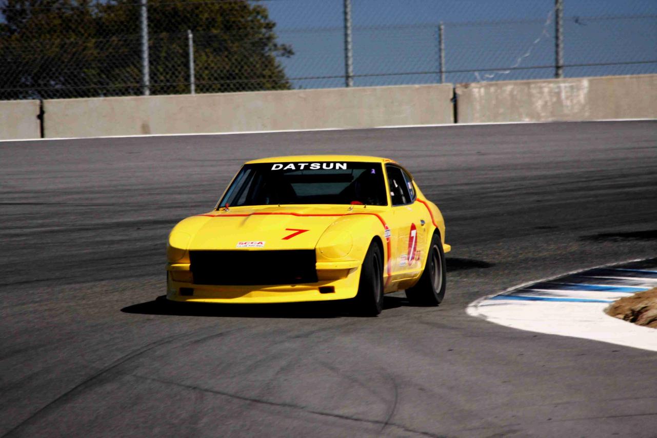

:ermm:Recently ran the car in Vintage at Laguna Seca and the thing wouldn't turn right. It just wanted to push straight off the track. This happens under light throttle application just after turning into the corner. The race before, the car was perfect. I've tried tightening everything and have found nothing wrong. Sway bars are snug. The alignment looks good too. I even tried rebuilding all four shock absorbers and the car still pushes in right hand turns. The thing is, the car turns left great. Now don't tell me to start running NASCAR, as that joke is getting very old.
Has anyone seen this behavior in a Z? I've been running a Z for over 20 years and have never come across this. Your thoughts?
