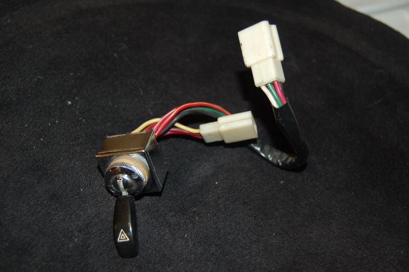

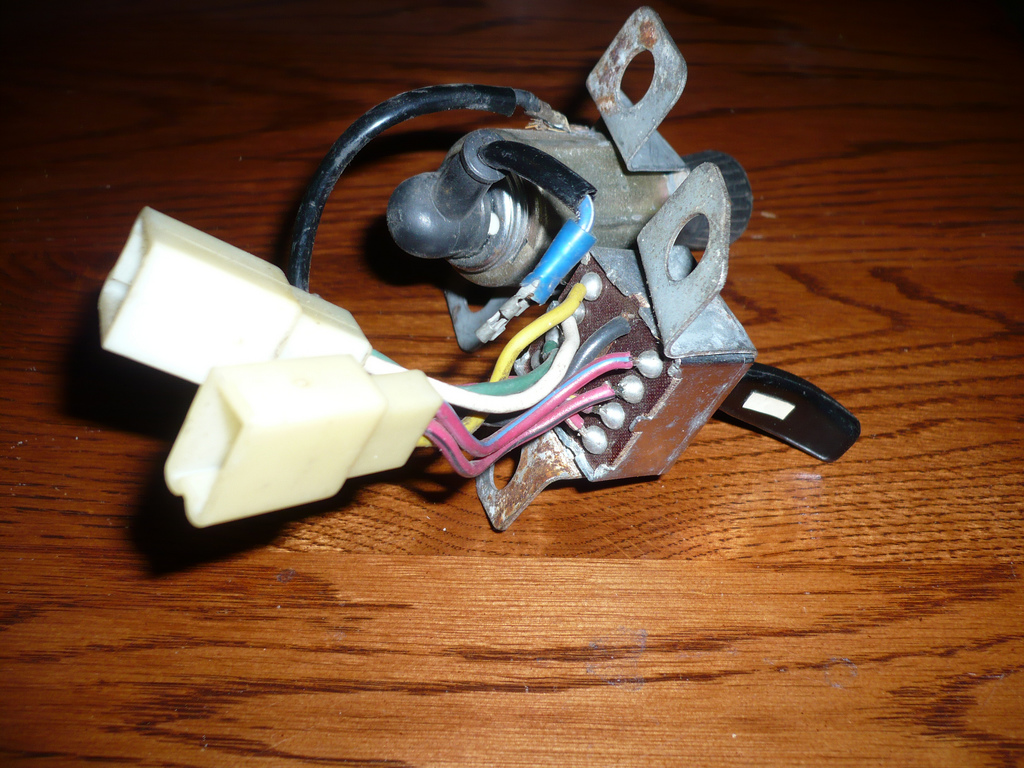

Sorry for the delay Steve. I believe I have what you're looking for but it's part of a complete hazard/lighter assy. Most of the white lettering (80%) is still in tact, and there's enough relief left to repaint it if you wanted to. I also have a Series I hazard switch missing the knurled mounting ring. Both operate crisply but neither have been electrically tested. I'll post pics tomorrow.
Edited by =Enigma=
Here's those pics. PM me if you're interested.

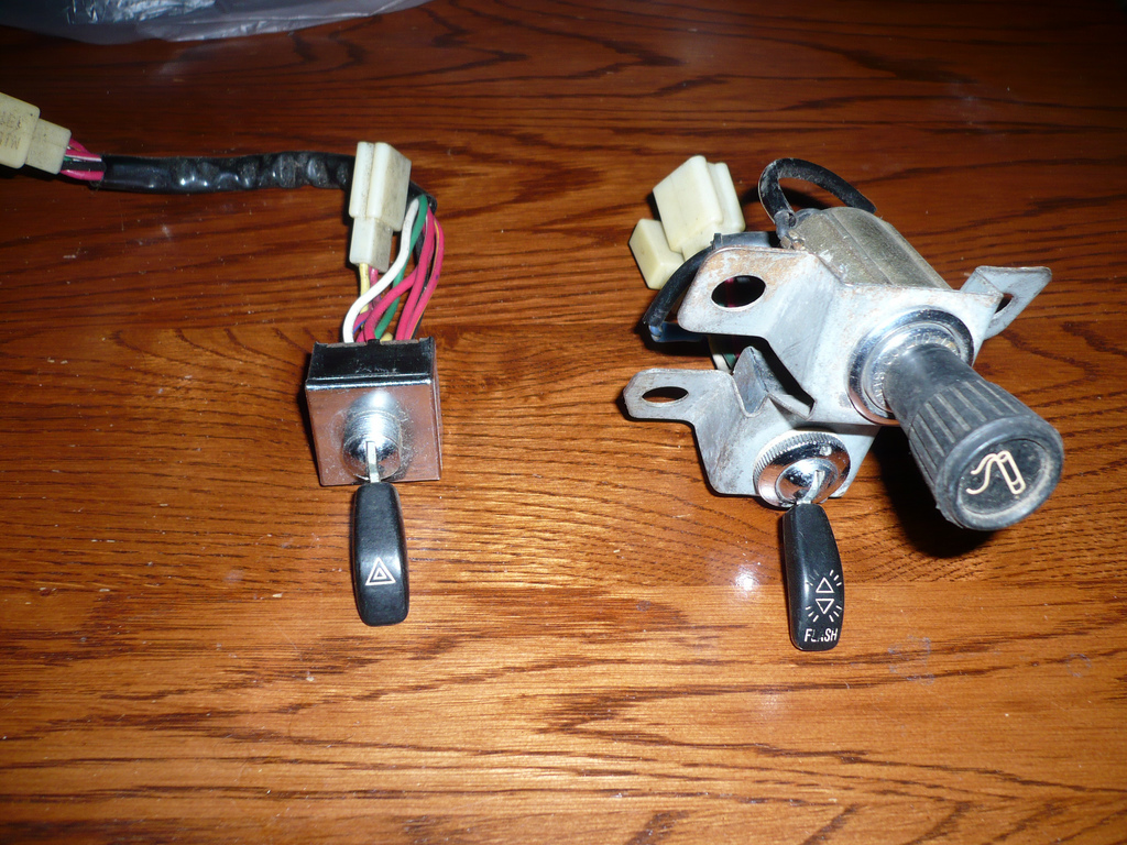

OK, I finally remembered to check my spares. I do have a good working spare switch that appears to be the same physical style as yours, but the logo on the handle is different. I think the one I have is from my 10/70 Series 1, as your 3/71 and my current 7/71 are the same. It looks like the early style has one longer pigtail, but may still work. The one Enigma has that's under the lighter appears to be the correct switch.
First picture is the spare, second is the one in my current car.
