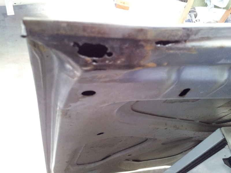

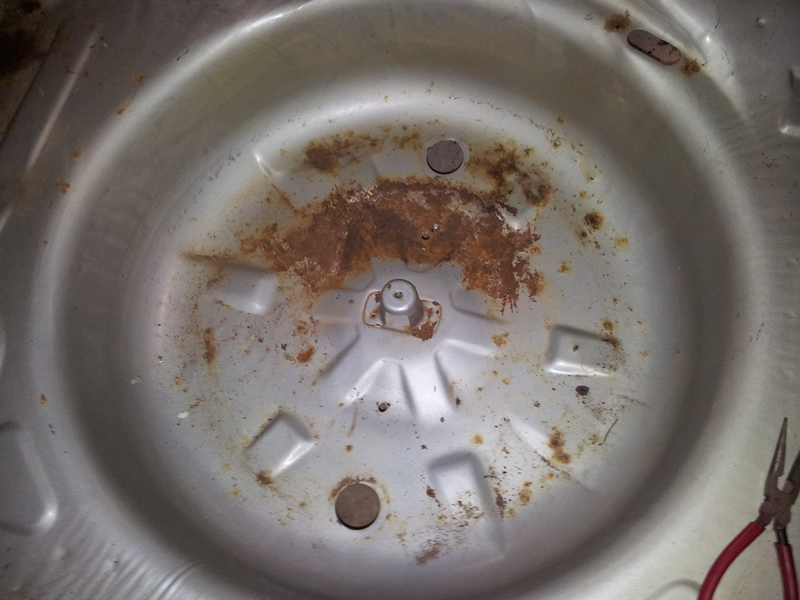

It seems to be solid under there other than a bit of rust in the rear arches, there's also some rust in the front passenger corner of the bonnet but the rest of the bonnet seems good, the bootlid will also need some rust repairs done under where the stainless trim goes. Around the windows seems to be extremely solid with just some pitting around the drivers side lower front in a couple of spots but no holes.

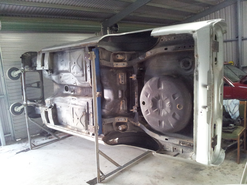

Adz, the jig is rather dodge but works :). It picks up the front crossmember bolts and rear cradle bolts and tilts slightly to throw the weight over the base loop. The main problem with it is A. I made it out of galv pipe that isn't really strong enough (it was free) and B. It needs more support at the rear of the car because I can lift the front of the car up with one hand which isn't ideal.
