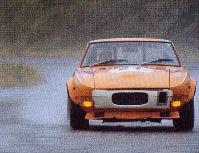

There's a picture of a 240 in Japan taken in the early '70s that has an aftermarket grille insert that directed air to just the radiator (with addition mods) and had an opening for SU induction hosing.

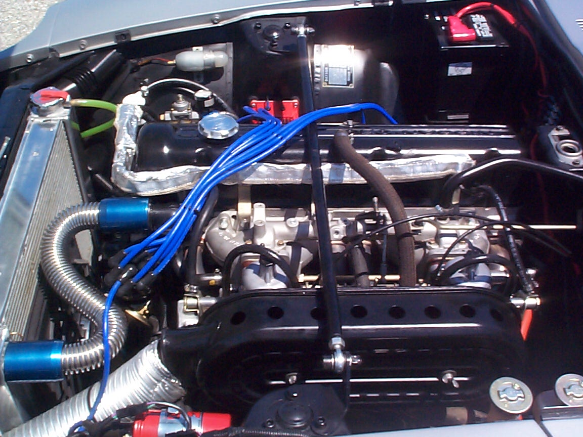

You could also drill 1-inch holes along the top of a stock air filter box, as per Dave Rebello's instruction to me a few years ago when I ran 2-inch SUs on my earlier set-up. That worked fine as well. The intake air isn't as cold but it let more air in without a whole lot of work on my part.

I have attached a picture of the Rebello suggested stock air box mod and the fiberglass insert once sold in Japan (this is Alan's picture). It did two things; 1) reduced the air flow into the engine bay by directing it to the radiator and 2) it had an inlet for a ram air duct to the SUs or triples.
