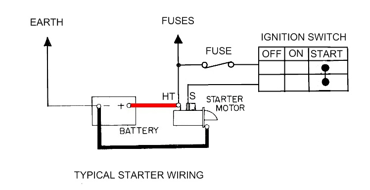

The starter is probably OK.
When absolutely nothing happens like this, it indicates that the starter solenoid is not operating, probably due to a faulty IGN switch or associated wiring.
You can check if the starter is capable of doing the job by temporarily bridging the large battery terminal HT on the starter to the starter solenoid spade S terminal.
This is what the IGN switch does anyway when you turn it to START.
The starter should kick in and crank the engine.
Make sure you are out of gear with handbrake ON, IGN switch OFF.
Then, as mentioned, find out why the IGN switch doesn't do what it should.

Ignition switch sounds like a potential culprit. Are there any associated fuses with the ignition switch (IE - something simple that can be checked before opening the ignition up to see if the problem lies within?)
Are there any particular wires to keep my eyes out for with the ignition switch? (things that typically go bad with it)

How old is your Ignition SWITCH (NOT the Lock)?
The Switch is the electrical portion that resides BEHIND the Ignition LOCK and is what the tab on the back of the lock turns when the key turns. There have been several owners (myself included) that have discovered that the bakelite portion of the switch (the brown "plastic") will actually SHIFT when the switch gets actuated and thereby not making contact with the Start contact.
I'm not saying that this is definitively the cause of your problem, but that this exact problem has had people looking at the Starter Wiring, Connections, Starter Relay etc all to correct the Switch's mis-connection. Take note that when removed from the back of the Ignition Lock and actuated on it's own, the switch seems to perform flawlessly... it isn't till you actuate it WITH the lock tab that you note the lack of total rotation needed to effect proper contact. That is what Nissanman's procedure will show you, that it is NOT the starter but the wiring connection to it. Before you go tearing everything else out, check the Switch.

Are there any good schematics of the ignition switch? (FSM?) I guess once I take it apart, it'll all be pretty obvious.

You won't need no "stinkin" schematics... LOL
The switch is attached to the back of the lock with screws. Remove those after removing the connector that connects directly to the switch.
Once you have it off the lock, try to rotate the bakelite (the brown "plastic" portion) by holding onto the metal front piece. If there is more than a small amount of "slippage", it could be the cause of the problem. The bakelite rotating more than a few degrees can cause the internal contacts to just barely touch the start terminal. Over time the switch gets sparked and burnt enough that it cannot make proper contact to power the starter relay.
You can try to disassemble the switch, but it may prove to be impossible to re-assemble it and have it be functional after cleaning it.
