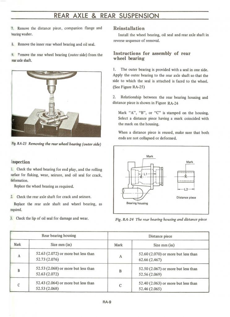

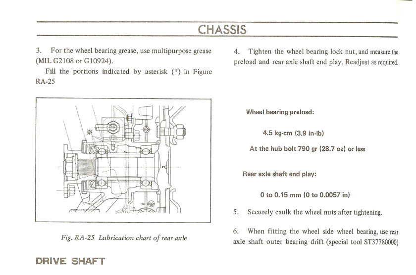

Hi Jim:
No problem - I was asking Julio or anyone that perhaps understood his first Post better than I, and I'm glad you answered.
Below are copies of the pages from the 72 Manual... my 73 Manual is in the garage right now - so it was easier to scan the 72 Manual in the office.. It is most likely the same as the 73.. No mention of the fishscale in the rear..

Bearing end play is given as 0 to .0057 in and bearing preload as 3.9 in*lbs or less. If you have more than 0 end play you will have no preload as there must be play in the bearings to have any end play. At 0 end play you must have no more than 3.9 in*lbs of preload. Since you can't
measure if you have less than 0 end play you use the bearing preload to make sure have not loaded the bearings too much.

After readng the post indicating it needs the 200 ft-lb torque, I went back last night and torqued both down to spec. No significant change in rotational resistance noted.
As a process check, I then removed the axle nut and inner hub to see of the rotational resistance was different from before. It was, but only very slightly, as the bearings have been driven onto the shaft into thier proper locations.
Based on what I've read in this post, I'll go with the 200 in-lbs torque and check for excess heat after a few miles, then again after 100 miles. I'll finish-up tonite with the shafts and the rear disc brake install.

Three possible issues here. In a couple of axles I've stripped, instead of the correct stepped outer bearing there was a plain bearing and a spacer washer and also as far as I know there are at least two different length spacers between the bearings the most common one being the "B" spacer. I have also come across the copper washer.

RE washers/shims. If you've got proper tolerances with the shim after torque you're in pretty good shape. Later down the road the copper or aluminum may introduce some slop though. (If you call .001-.0015 slop) Since the OD of the bearing bores is a "loose" fit the designer would have wanted the faces of the bearings to register at the bottom of each bore. This would help keep the bearings aligned. Antifriction bearings are very sensitive to misalignment.
