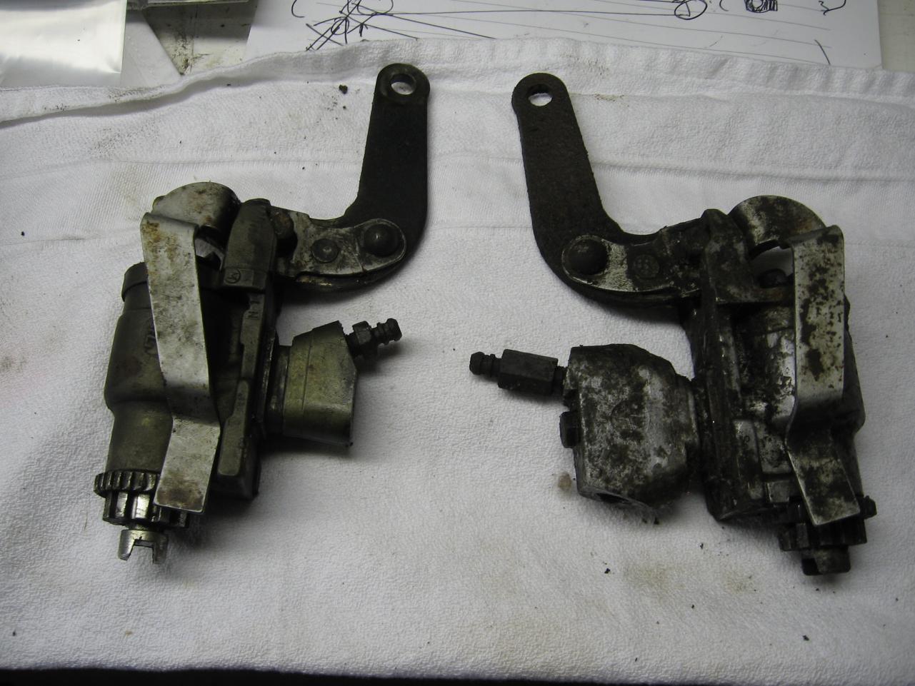

Call to MSA was separate, after I discovered the cylinders were different. I've attached a pic of the ones I pulled from the car.
The two I purchased are both like the one on the left. The "New" design according to description in Humble. I think I have a case with getting a return on both as from what it says in Humble, prior to 9/72 the "former" design was used on both.

Interesting find. I went through my photos from when I changed my brakes, but unfortunately didn't take any pictures specifically of the cylinders themselves. I do know that mine were the same type though, just mirror images of each other. I even went outside just now to have a second look and make sure.
Quite odd that you have two different ones. Especially as the Original owner doesn't remember having ever modified them. One possible explanation could be that perhaps some time in the past, when it was a relatively new car, it was taken to a dealer for service. Maybe then one side of the car was updated, backing plate and all, because damage was found? I'm just throwing out a guess there.
As per Humble's book, I would check the backing plates and rest of the brake assembly to see if they are the same, or different. If they are also different, then you either need two different wheel cylinders like the ones you removed (one early, one late), or you would probably need to find a backing plate and assembly from an early Z to swap on.

Thanks again. Do you remember if yours were the "former" or "new" style. I think I have a case for an exchange or return because as I understand it, both should be the "former" type, but the ones I bought although labeled for 70-76, are of the "new" type.

Okay, I finally got a moment to crawl under my Z (it snowed on Saturday), and mine are indeed just like they should be, the early or "former" style. Brake hard line at the front, bolt and copper washer in the blind plug hole, and bleeder at the back end.

that's great, thanks for checking. I think I'm going to ask for a refund or at least exchange for something else, then order the 2 from MSA so that at least I'll have the same manufacturer for both.
