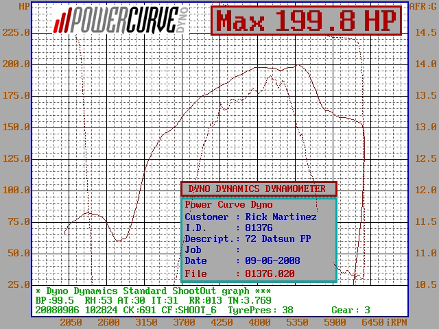

Ok here's the deal, the SCCA Solo National Championships are less than two weeks away, I spent all last week thrashing to install my new Stahl header and fabbing up an exhaust for it, dyno'd on Saturday and got some decent numbers up top but I seem to have introduced (or exacerbated) a bad bog between around 2250rpm to about 3250rpm. This is a terrible place for a flat spot on an autocross car.

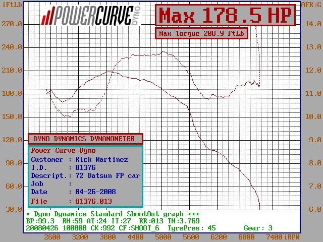

Obviously, eliminating the bog is my goal but even reducing before next week it would help tremendously. Attached is the dyno chart from Saturday and a chart from April that is pre-exhaust work, the only major change between the runs. As you can see, the exhaust work really woke up the motor above 3250rpm!
These dyno runs were performed starting with a load at WOT at 1800rpm then then removing the load and allowing the car to accelerate the drums, at least that's how I understand the basic concept. I only mention this because this method takes most of the mechanical action of the carburetors out of the loop (in other words, this is probably not an acc pump issue, progression drillings, etc.)
Also plotted on the dyno charts is the AFR for each run. I tuned the jets so that the target of ~12.9 hit just over 5350rpm and the upper AFR "step" in the midrange was a little leaner than that but not dangerously so. Based on my understanding of the carbs (I have read the Mikuni manual and several Weber books) that seemed like a logical tuning plan. If I'm way off base here, please educate me. Maybe the "step" is a clue?
At the point of the bog the AFR goes way rich (<10:1) and the torque drops. The same dip in the AFR is on the pre-exhaust pull but it's not as drastic, and you can see a similar dip in torque. So, it looks like this issue may have been present before just not as bad.

You say you fabricated the exhaust system yourself? Z's are reknowned to have a flat ("bog") spot around 3000-4000rpm. This can be eliminated to an extent by having the longest secondary pipes you can get in, preferably back to the gearbox and then run into the Y piece. I'd be interested to know where your Y piece is. Not sure about running 2.5" into 3.00" either, depends whereabouts on the system it is.
You AFR during the blog is way too rich basically flooding the engine. Try and use a different emulsion tube because your gas/air jets look to be about the right ratio.
I had an almost identical issue on my road racer, it would fall on it's face in that rpm range. I spent quite a while playing with the jets on the Mikuni's but it ended up being CAM TIMING. It was advanced a bit too much, spent the winter degreeing it and now th stumble is virtually non-existent. I traded some emails with Dr. Sideways (Alan) afterwards and I beleive he said he had the same problem as well. It was kinda fun driving it that way, once past that rpm range it felt like a turbo spooling up, she would just take off.
My exhaust is a Nissan Motorsports 1 5/8 primary 3 to 2 header with custom 2.25" duals straight out the back capped with Supertrapps.
EDIT: I should add, the stumble wasn't present until I opened the exhaust up a bit by adding more discs to the 'trapps.

You would want the cam advanced for low end. Retarding the cam gives high end power. Opposite of spark timing.

Try going to a 40 or 45 pilot jet,then readjust your idle mixture screws for proper idle.I had this problem also when i was racing FP. I also would not count out adjusting the cam.With the size of your cam i would consider what type of track you race most ,then make the proper adjustment,ie... advance the cam for short tight tracks,retard the cam for long high speed (auto x speed) tracks.
