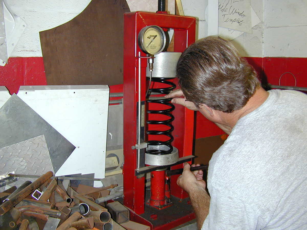

If you can get an accurate measure of the wire diameter used in the Eupo Spec. Springs - we can get pretty close to what they would measure out to be. You have to find someone that has a coil spring measuring machine to get accurate measurements. The Coil Spring Measuring machine will be able to hold the spring in place, then compress it to 80% of its free length - then take load measurements as it is compressed an additional inch or two.
Call Race Car Development shop's in your area - and you might find one with the necessary machine to measure the coil spring rates..
