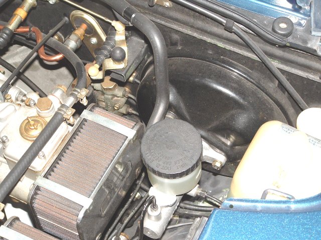

Yes it will fit. Just flip the ZX booster upside down and reverse the master cylinder. Loose the aluminum spacer and shorten the mounting studs.
Here’s a ZX booster on my 260Z (which has the same bolt pattern as a 280Z):
Steve,
What kind of Master Cylinder is that? I'm used to seeing two reservoirs.
It's a 1" diameter master cylinder from a Nissan Hardbody truck.
