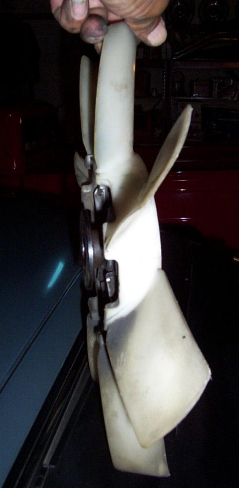

Here are the two different fans. Note the mounting surface locations. The first one will sit farther away from the radiator than the second one.

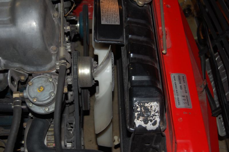

Here is a picture of my fan with my existing radiator. I believe that the plastic fan is version 1 in your diagram above. I am trying to find a clutch assembly that doesn't stick out as far from the engine so it will not hit the aluminum radiator I am installing. It is a 280Z engine, if that makes any difference.

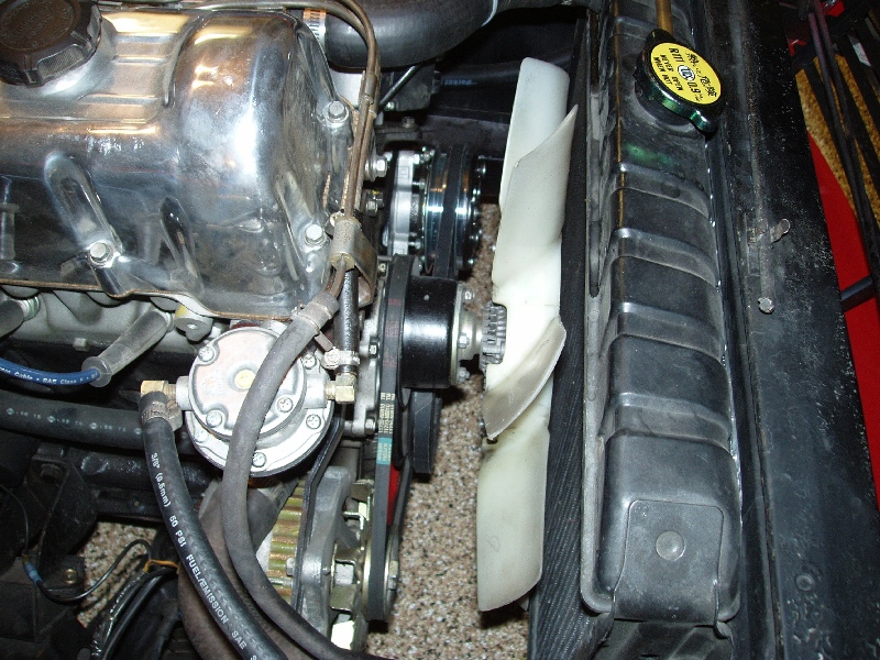

The fact that I can see the clutch through the openings in the side of the fan tells me you have fan type number two. 280Z engine or 280ZX engine? Generally, except for the 79 the ZX had the type two fan and that's what yours looks like. Take a look at my 78 clutch and fan. Even though the shroud is kind of in the way you can see how it sits back farther than yours. The one I'm holding in the picture is a good spare, same type as the one on my car and it works fine. PM me if you're interested.

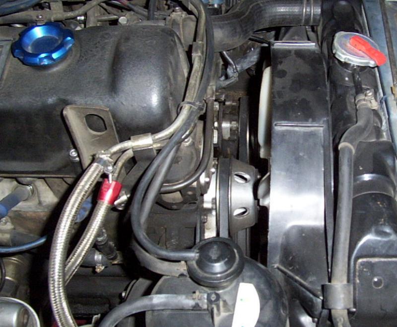

I think Mr. Blakeney is correct, Mr. Duff. Looks like you have the ZX fan to me. Here is a picture of the clearance i have on mine. i replaced my original metal fan and clutch with one from a 260Z. I have an inch, at least.
The ZX/810/Maxima clutches are actually a little taller than the S30 units. At least, the OEM ones. Compare the distance from where the clutch mounts on the water pump to the back of the clutch in your picture to my or Arne's picture. So the combination of a S30 fan clutch and fan will definately give you more clearance.
