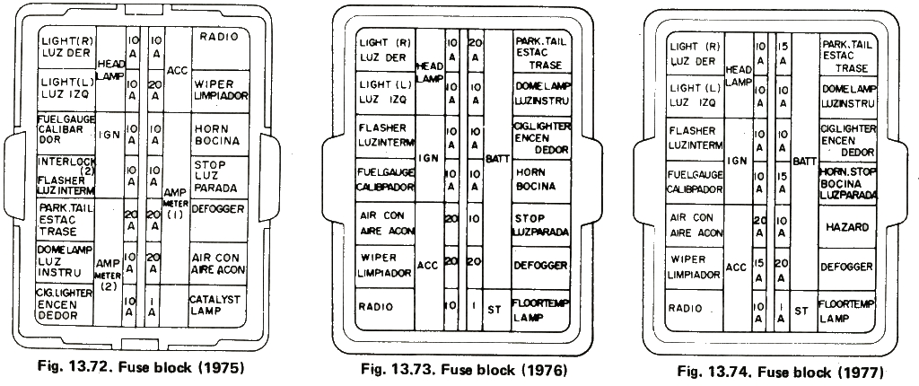

Can somebody post a picture of their 1975 Fuse Box Cover. Mine didn't come with one and yesterday I was looking at some of the fuses and they look pretty old and brittle. I would like to swap them out but I don't know what is what down there.
https://www.classiczcars.com/forums/topic/27526-1975-fuse-box-cover/
Thanks, are all the 280z Fuse Boxes the same no matter the year?
No. That's not from my 78 but I still sent you the wrong one. The one I posted is for a 76. Must have been a case of temporary aixelsyd. (Dyslexia)ROFL
Thanks for all the help. I went ahead and changed out most of the fuses. Seemed like as soon as I touched them they stopped working! Seems like the PO did not like to use the recommended fuses. Everything was working so it didn't seem to hurt anything.
