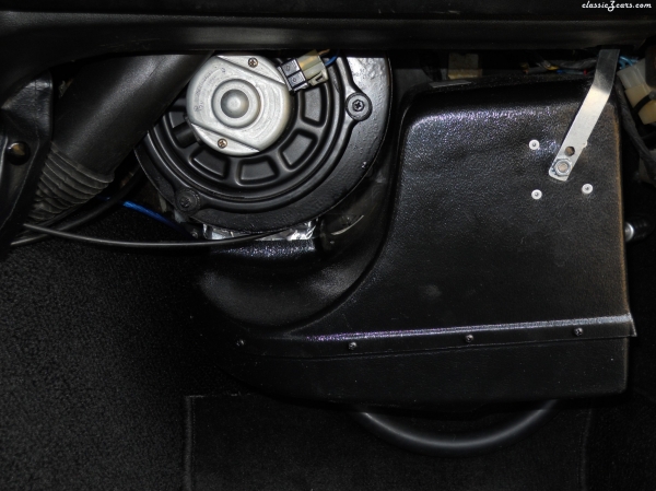

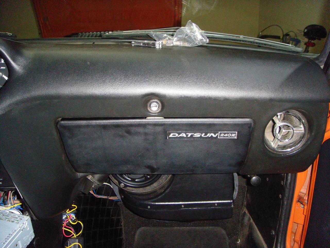

I'm guessing you figured out the answer to your question by now, but I figured I'd post a picture of my MSA kit for anyone else who comes looking.
It hangs down quite a bit, and if I had to do it over again, I would probably go for the Vintage Air blower and evaporator/heater box.
From the pictures I've seen, the Vintage Air blower seems to only stick out into the volume where the original blower motor and box were located. The MSA evaporator box hangs way down, and it kinda intrudes on the passenger foot area.
Also, the draw-through design of the MSA evaporator is definitely less than optimal. The Vintage Air unit is a blow-through, and should yield much better results.
