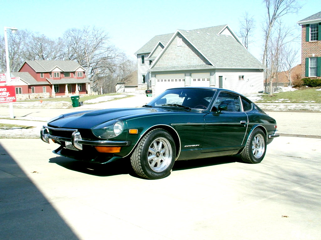

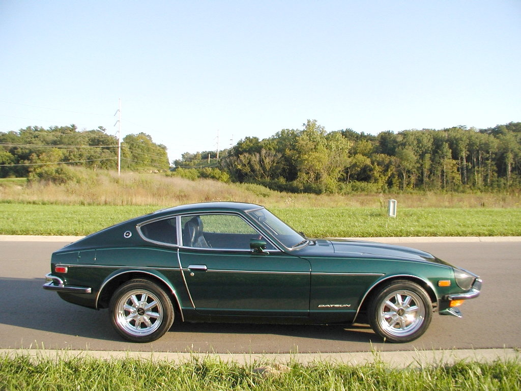

I spent a lot of time and concluded the following. For balancing a comfortable ride and strong/aggressive responsiveness 15" or 16" rims are a good balance. I had Yokohoma 205/50/15's on my 7.5" wide rims and the car handled nice, but the tires did not fill the wheel and the car lacked comfort to my liking as well. See photo #1. I just installed BF Goodrich G-Force Sports, 205/60/15 on my 7.5" rims and was extremely pleased. See photo #2. Inflation was also important - the BF Goodrich g-Force tires for the Z-car (1000lb /tire Load capacity) would be 24psi -26psi Cold according to BFG - I keep them at 25psi cold. The ride has been excellent, my Speedometer is now accurate (60.5 MPH actual versus 60MPH on my speedo).
