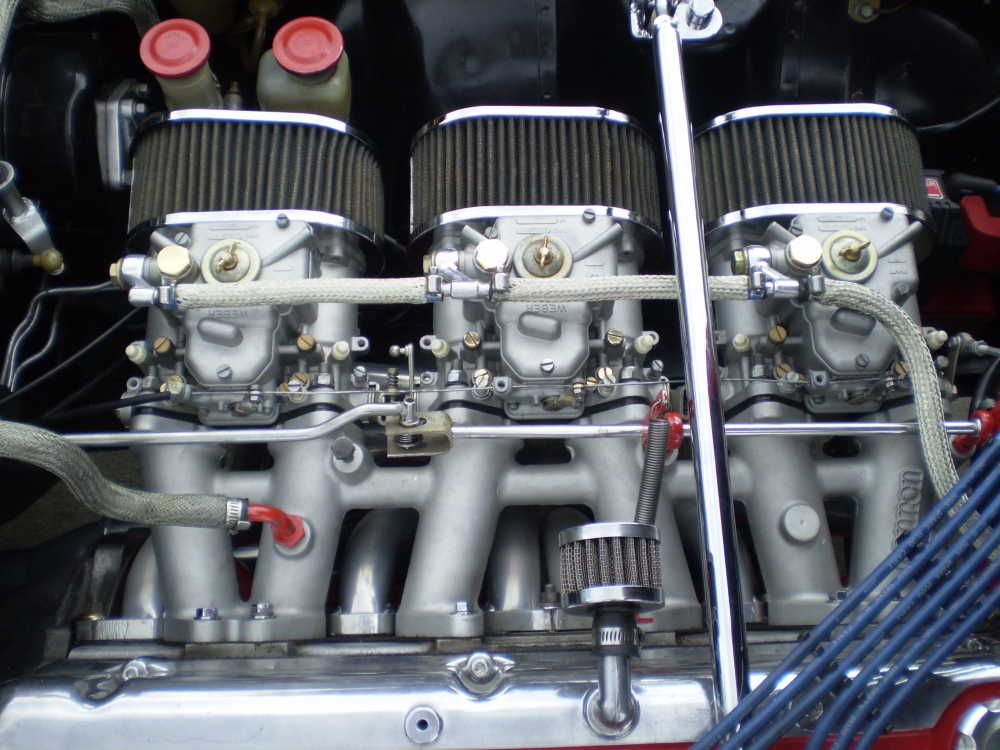

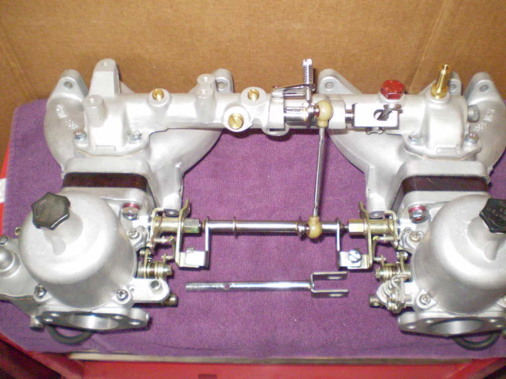

hold on, I think ya missunderstand what I'm getting at. When I glass bead the S.U.'s, ballance tubes, intakes and other aluminum, I do that for that "Cast Aluminum" look. Which is the look they usually have when new.
I would never bead or shell blast any Aluminum part that would be later polished. Below are some examples of the SU parts that got bead blasted for the final "cast Look"
pic #1 is of my current triple Webers and Cannon Manifold after I glass beaded them before rebuilding them and installing them on the Z
pic #2 is a close up of the SU's I sold a while back
